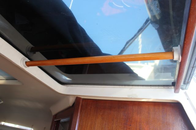

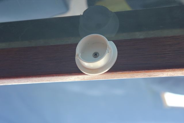

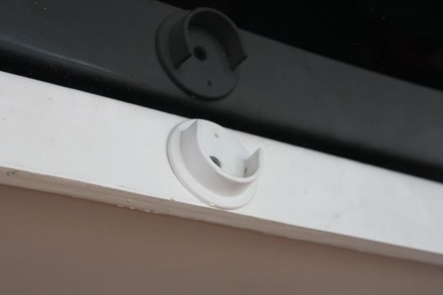

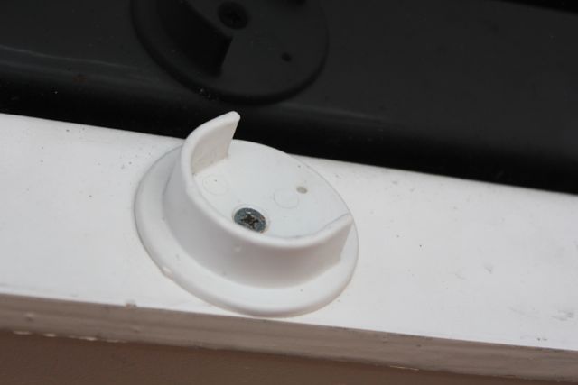

I just use a length of broomstick that fits under the sliding hatch section. It's held in place by shower rod holders at either end. Easy to remove in an emergency.

Could you post a photo of this?
A picture would help me understand what you are doing. Thanks.
