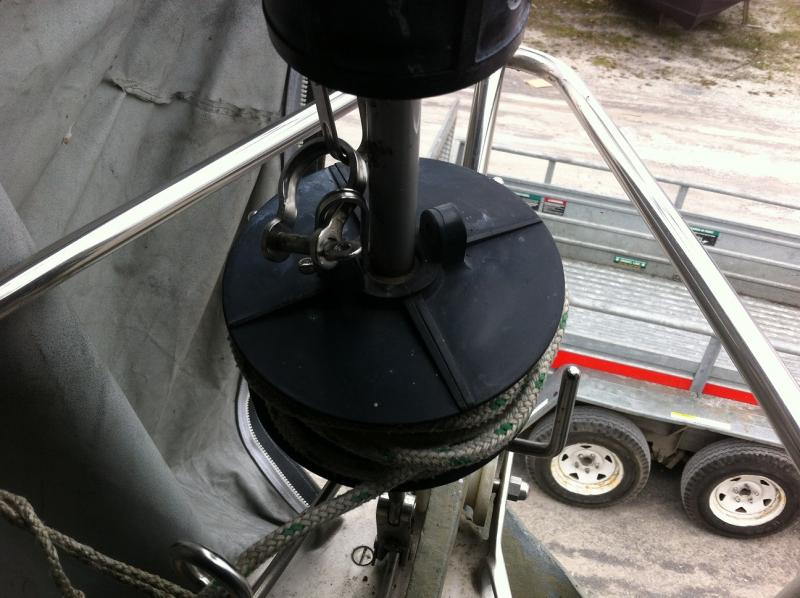

This furler (see photo) has a lunchy drum bearing.
Attempting to determine manufacturer, to see if replacement parts are available.
No marking on unit. (May have been an adhesive label that has fallen off.)
Any idea who made this?

Hmmmmm, I suspect the drum needs to be identified and replaced.
I could be mistaken, but I don't believe it has a removable steel roller bearing (in which case I would take it to our local bearing place.
I think most furlers have composite (Torlon) bearings in race that is integral to the drum casting.

It could be an early Cruising Designs (CDI) Micro or Micro B spool, maybe. Its hard to tell from the picture. There are no bearings in those. It would just need a good flushing with fresh water. Actually, that might fix whatever model it is. Have you tried that?

It looks kinda liike a CDI to me too. Give them a call, real good folks.

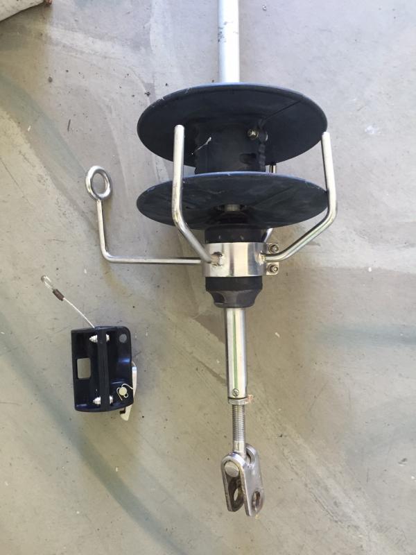

Is this it?
Does the rest of the unit look like this? If so, I'll continue my thought, otherwise I'll keep it short for once!
Nov 21, 2007
673
it's an Isomat Isofurl model #8, and it was the original furler on our Beneteau First 285. I was able to get parts for the system at RigRite.com. They have parts pictures, descriptions and some diagrams, documentation and specs on their website. What is pictured is what I have left of it after installing a new system. I'd be happy to send you the bottom assembly for the cost of shipping. Does your system use the halyard hoist locking car? The one in the picture is a replacement part that I purchased from Rig Rite, it's a pricey little part, but it isn't doing me any good in my garage... Send me a PM if you are interested in either or both.
