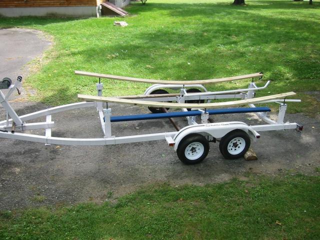

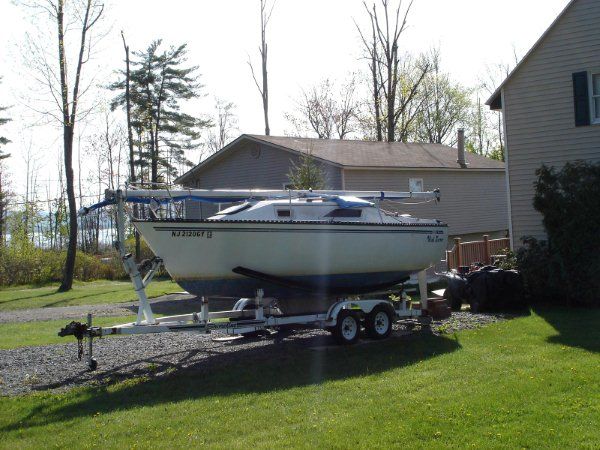

The bunks would definitely need to be higher. Here are a couple of pictures of mine. The first picture of the boat on the trailer when I first bought it, and the second of a work in progress of replacing the bunks and carpet this past summer.

Ben&Di, wow, those are two great pictures that you included in your post. thanks for those! Am I correct that your H22 is also the centerboard model and not the fixed keel? By the way, I love Sacandaga lake. I have land in Saratoga and go to the Adirondacks frequently to canoe and camp. What make of a trailer is that in your pictures? I can't make out the logo.
