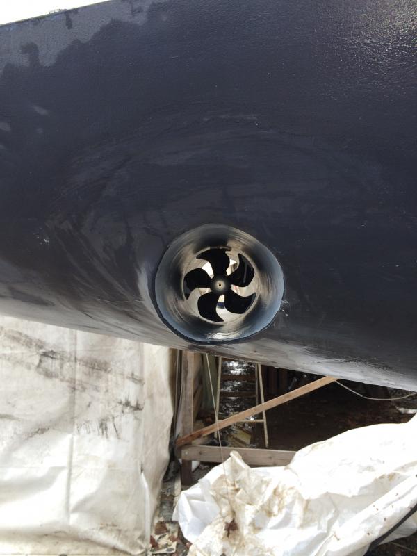

I have finally got a bowthuster installed on my h356. It's a Side Power SE60. I will publish pictures from it on the pages Owners modification soon. Tomorrow the boat will be launched and I can test to see howi it works. Looks good ashore.

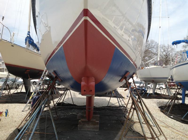

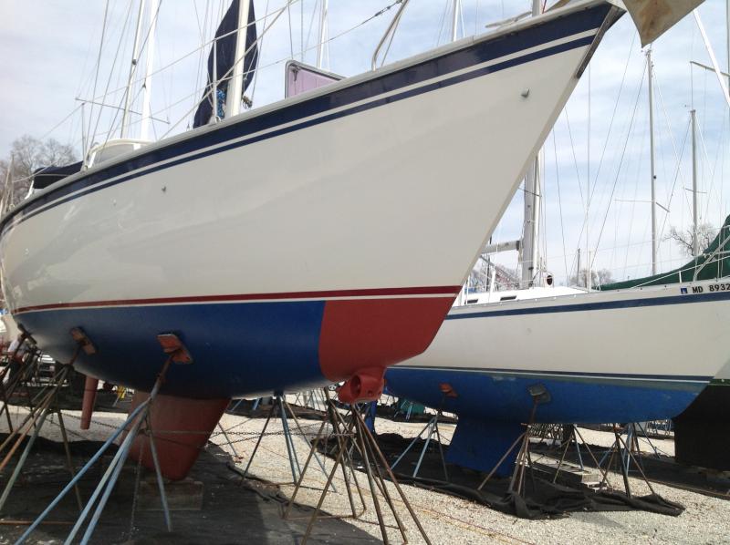

We installed an e thruster on our H36 this year. Used it for the first time on opening day here in Seattle, had an opportunity to use it to get out of a difficult situation when rafting up and again when pulling the anchors. The cost was about 6300.plus the cost of batteries and cables less than 500. We took two days to instal, not difficult, except the part where I had to drill a 2" hole in the bottom of our beloved little boat. :)

The boat is launched and the SidePower SE60 bowthruster tested in reality. Works good and is really a good help/support in narrow places. It is placed just behind the watertank.

Hey Patrik
Looks good. I thought wrong on this. I did not think I had enough room in my H356 bow area however after looking at your install,it can be done. Any issues so far ,pro or con.Is it working OK.
What size motor are you using and can it handle any current etc.?
thanks for the pics
Richard

Hi
It's a Sidepower SE60 and we have been out for a week now and used it several times. It works really well and saved many situations. It's electric and the preassure is 60 kg. I think it's possible to install a 80 kg pressure. You can find more info on www.valetta.n.nu/projekt. Use google to translate.
