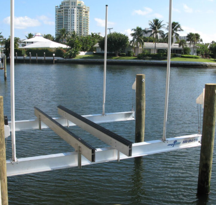

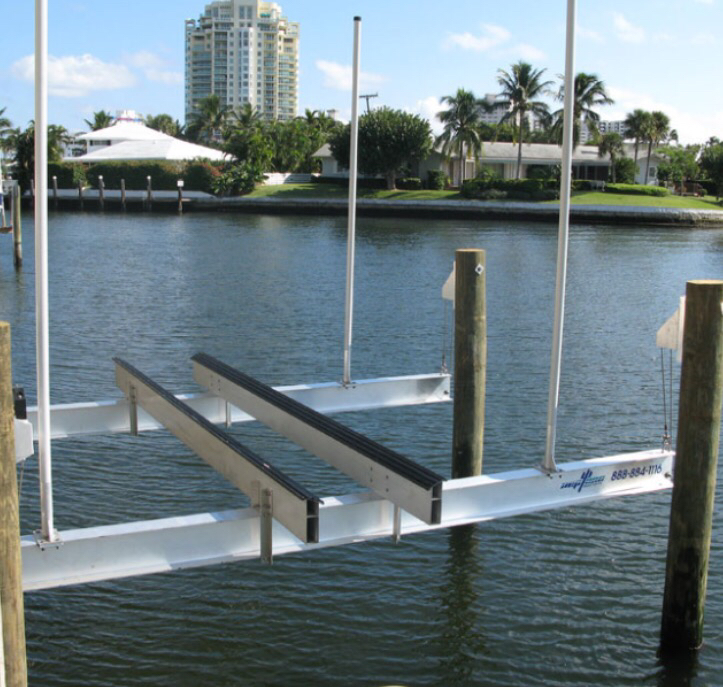

The boat lift pictures just for reference regarding how my cradle is configured. The two rails are adjustable along the beans.

I wouldn't do it. Those rails are too thin and how would you know where to place them? A haul out with straps has the load properly placed at strong bulkhead points.

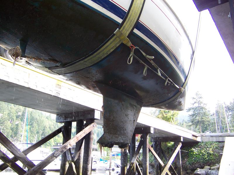

I would think you run a high risk of hull damage with the small surface area of the rails.
The straps on our marina lift are about 18" wide, soft, and wrap around the bottom of the hull to distribute the load over a large surface area.

If that first picture is the style of lift then straps won't work. The hull will sit on the cross I-beams. Probably will if you try to use the rails, they are not tall enough.

I was planning on spreading the rails slightly and building up the rails with a hard rubber material to somewhat follow the curvature of the hull. I also like the strap idea which I will explore.

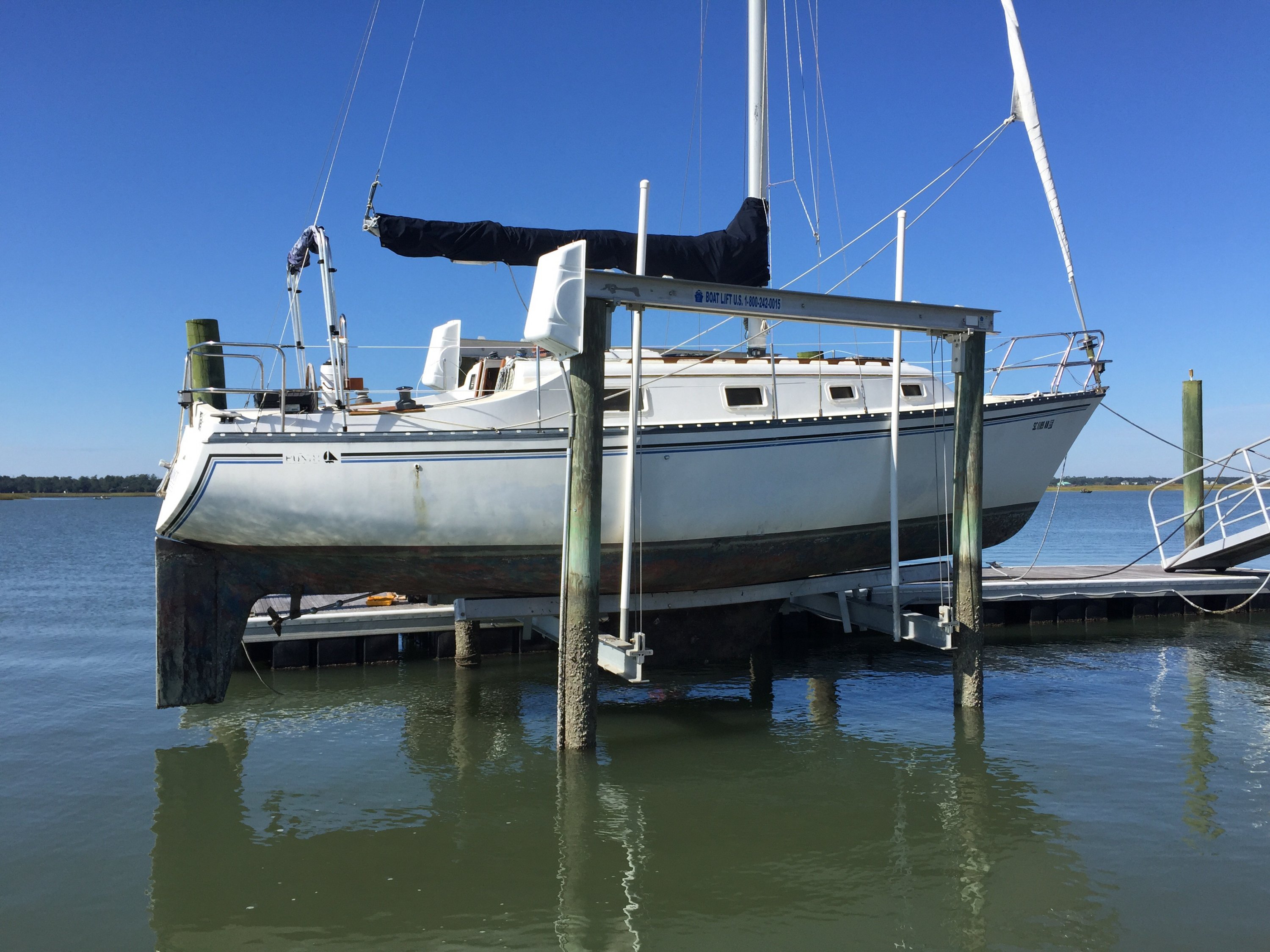

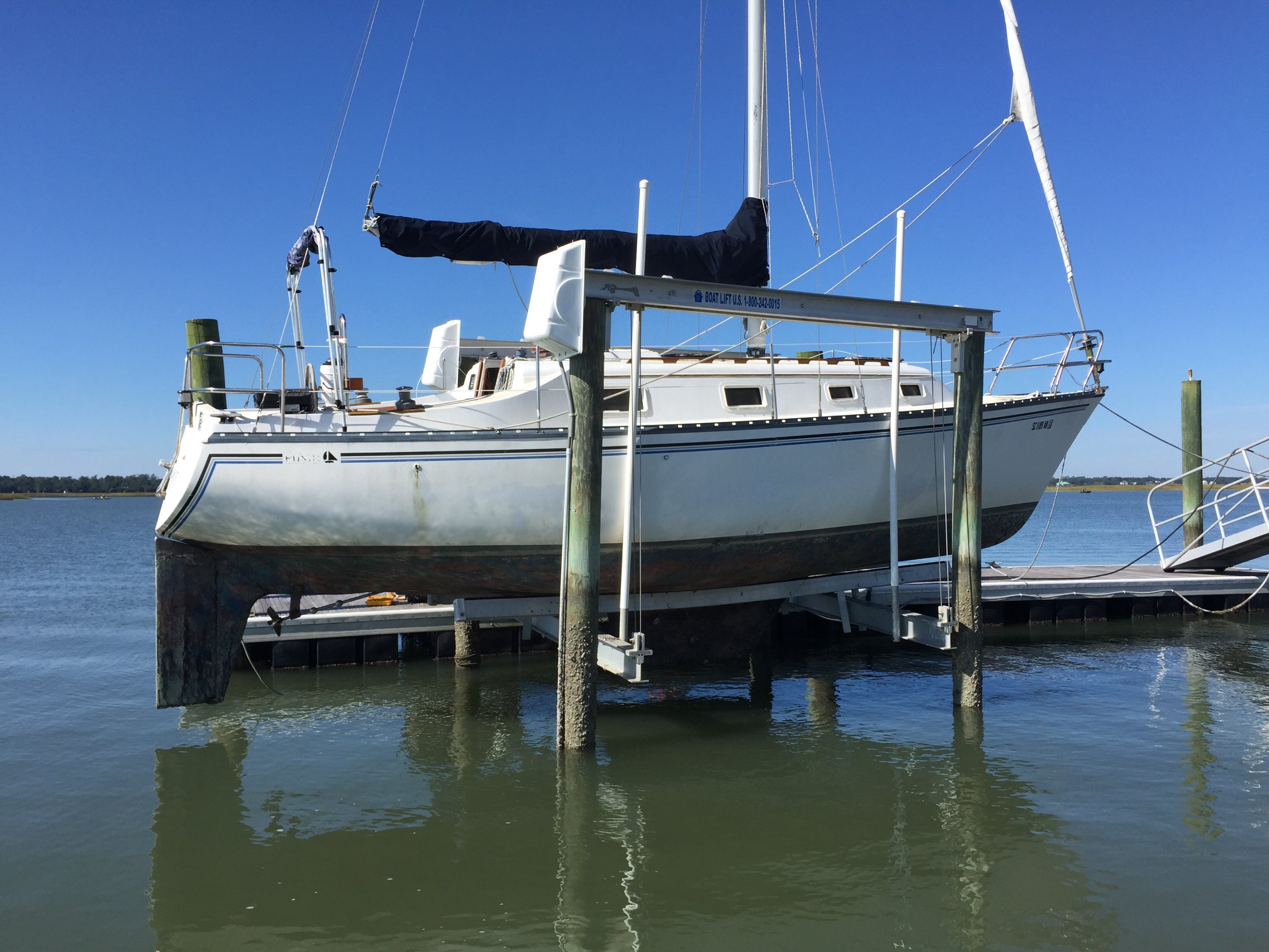

The lift worked fine and had no problem. Good for inspection and quick cleaning. Probably not a good solution for boat storage.
