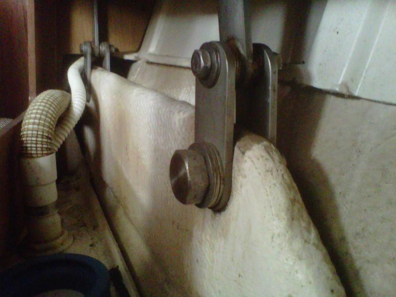

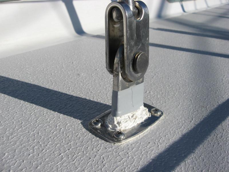

I recently had a rig inspection and the very experienced surveyor did peer at my chainplates. (Couple of pics of my chainplate arrangement attached just for fun.) The potential for hidden crevice corrosion and inspection was not raised. Also, the boat's standing rigging was totally replaced and the mast down in 2004. I would hope that some thought about chainplate condition was made at that time. Boat was then left on the hard until I bought it in 2007 ... safely away from salt environment.
I really would prefer not to slacken a few shrouds and dig out and remove some of my chainplates for inspection. But chainplate failure does seem to be an issue with older boats.
