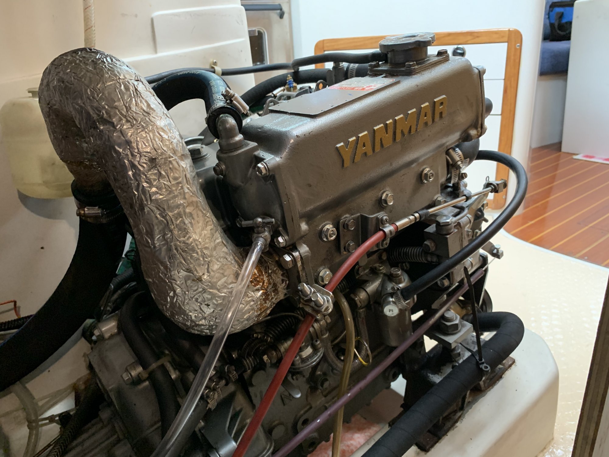

My boat came with the wrap on the mixing elbow. I attempted to unwrap it once just so I could examine the condition of the elbow when I had removed it. I quickly gave up the attempt and left it in place. I'm not sure how one can examine the exterior of the elbow with the wrap on it. BTW, at first glance it looked like aluminum foil so I thought it could be removed easily. I'm guessing that it would have to be cut off with a grinding wheel or something.
There is absolutely NO reason for you to have done that.
You don't have a mixing elbow, you have an exhaust riser. The ONLY place an exhaust riser on most all Catalinas with non-Yanmar engines fails is at the nipple where the exhaust water enters the riser just before the muffler.
Here's a picture of your riser and a discussion of the wrap. The new wrap is somewhat different than OEM, but same concept.

Well, in any case, the exhaust riser that you referenced is the replacement part for the "elbow" on my boat. The photo below shows the wrap I found and didn't bother to remove once I tried and failed. It looked simply like foil to me, but once I had a closer look, I found that it was not going to come off easily. So, I left well enough alone. I didn't have any particular reason for removing it, other than it looks somewhat janky to me.
Janky or not, that section of the riser will get very hot upwards of 800° F because the cooling water is injected after the loop. On the 3JH2E the cooling water is injected at the top of the loop and the whole unit is less than 4" x4" so it stays relatively cooler.
Right, I took the riser off mainly because I wanted to see the inside of the pipe. Not being familiar with the insulation, I thought the wrap was merely multiple layers of aluminum foil. Finding that it was insulation and seeing that the inside of the pipe wasn't clogged, I simply put the riser back on just as it was.
