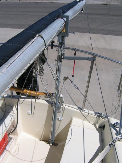

The mast on my 8.0 is heavy but I'm to old and like to do things by myself, so I'm going to rig a gin pole like my last O'Day. Lots of gin pole ideas on the internet. Here is mine.

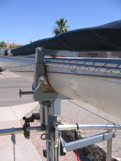

If you have a roller on the crutch it makes it easy to handle the imbalance that might occur. I have a crutch at the stern rail on the 8.0 and the mast has about 5 pounds of weight at the step when inserting the pin. About 30 seconds into my video you will see that I raise the roller to bring the mast out of the rest. I don't like trailering with the mast groove just resting on the roller. That roller can be raised about 4' (1.25 square tube inside a 1.5 square tube with 4:1 purchase) to help with clearance of things near the mast step, like the hatch cover and wheel on my 8.0, and give a better start angle for the gin pole.

The 1.5" tube has a slot cut in the front of it. This allows a 5/16" bolt with a tab welded to it, that is screwed into the bottom of the 1:25" tube (nut welded inside), to move up and down. This slot keeps the 1.25" tube captured for it's full travel inside the 1.5" tube. I originally had a handle in place of the 5/16" bolt to manually lift the roller but pulled some old blocks out of a box and hooked up the 4:1 purchase which is much easier. There is a lynch pin that can lock the 1.25 tube in several different positions for safety. Make sure to use a roller that allows the spreaders to pass over the top. I think the only change I will make is build the unit more vertical. It's at about 10 degrees leaning toward the stern and there is more friction inside the tubes, which wears the paint more than I would like.
There is a way to do all of the lines internally with out the slot but adds weight, size, and complexity. A line operated adjustable whisker pole will show you how this is done. You just need clearance for the line inside between the tubes, which then requires some plastic bushings to take up the extra space, and some sheaves to route the line.
If you have a Dwyer mast step, like I have, the position of any crutch at the stern is critical. Perfectly centered may not be right if the step is installed 1/2 degree out of alignment. Play with the pin at the step to find where the mast needs to be positioned, at the stern, to allow the pin to go in and out easily. I see people at the step with hammers and all they need to do is move the mast a few inches left or right. Function over aesthetics is my motto.

Thank you for the photo and description of the crutch assembly system. It helps me visualize how it works.

The crutch in the video is on my previous O'day. Our S2 has been undergoing refurbishment since I bought it. I've raised the mast just one time, to check standing rigging lengths, using a temporary crutch from lumber and some old roller I had laying around. Both the O'day and the S2 had about 5 pounds of weight at the base. I've had other boats that had a negative 5 pounds at the base and since I was holding the base of the mast as I pushed it back on the crutch roller there has never been an issue. It only goes negative in the last few inches.
You will have more of an issue of shrouds hanging on something as you roll the mast back. At 50 seconds into the video you will see me check some small line that goes over the lifeline and around the shrouds. This holds the turnbuckles up so they don't hang up (and bend when raising the mast) and also keeps the shrouds from hanging on deck items as I roll the mast aft.
An easy way to check where to put the crutch is measure from the mast step to the future location of your crutch. Then support the mast at that distance with something and see how much pressure (weight) you have plus or minus. A point where it's perfectly neutral would be the best for pin insertion IMO.
