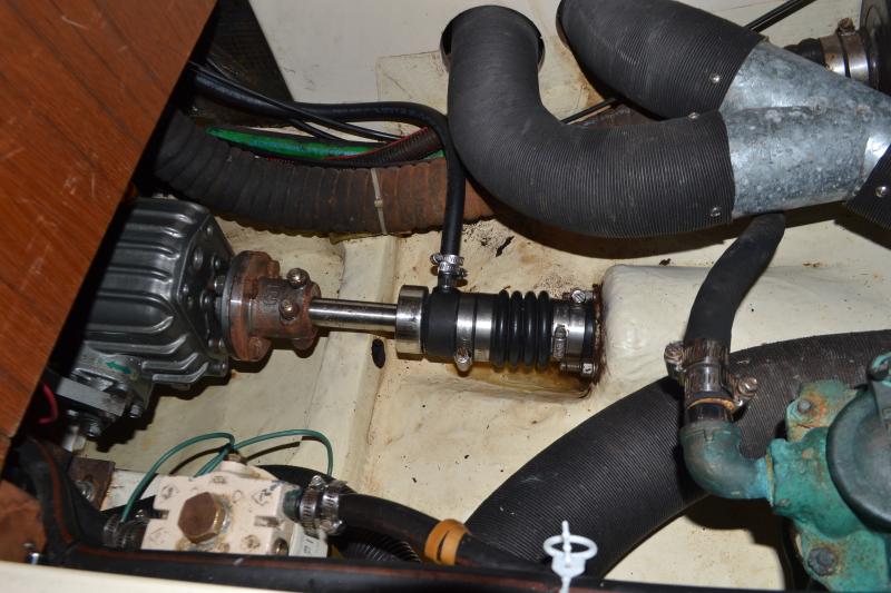

Previous owner had installed one on my 2000 340, I recently added a shaft collar from PSS for a little extra peace of mind, hose goes to the mixing elbow on the Yanmar.
Not the best photo, but I had it in the boat file on my computer and it shows plenty of room, I beleive PSS specs say 6.225" length for the 1" shaft model.

Great, thanks. One of the things I'm scratching my head over is that the existing shaft log is mounted to the hull with two bolts, which appear to be so close to the body of the log that there's no room to slide the hose on properly. I was hoping the rubber hose for the dripless seal was thinner in profile and would slide onto the log properly. Looks like it does judging from your picture.

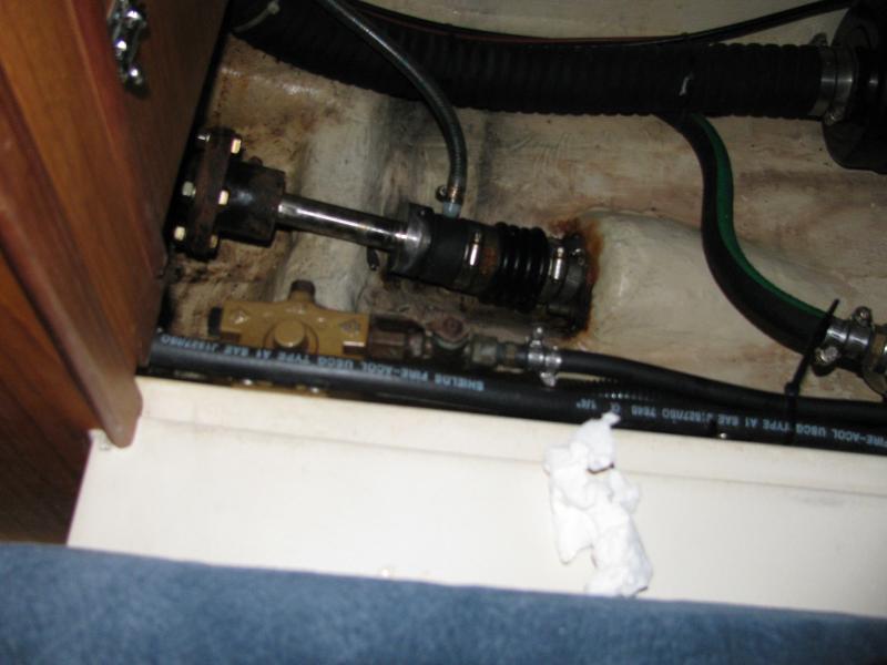

Ok so I've been diligently following along this thread for my own education.
I just purchased a 79 30' and relocating her down the calumet river into the Mississippi where she will be trucked to her new home on Lake Carlyle here in Illinois.
My concern is due to the week long motoring down the calumet into the Illinois, etc. etc.. I am naturally wondering about the integrity of my packing gland. The PO did not know what type of gland was down there so I had to inspect and much to my suprise (and delight) there is a dripless in place!
So the run is since the PO didn't know what was down there and he owned her for 1-12 years, how much more life should I expect or should I replace it now before my week long journey?

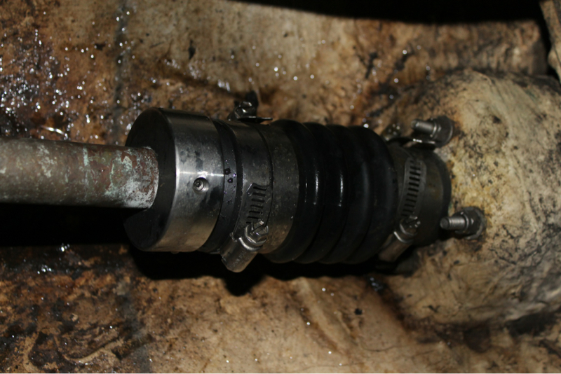

Here is how it looks on my H336. Just installed it this summer. No problem with clearance.

Re: Any 336 or 340 owners with a dripless shaft seal out the
The PSS I have is an older version like yours without the hose. These need to be 'burped' to get the air out after launching. The new ones do not. The original advice I got from them was ten years or 1000 hours to replace the bellows; I believe it is less now. I have done that twice and each time the bellows looked and felt like new. I keep the old one as a spare, although there would be no way to put it on without taking the shaft coupling off, so it's stupid. Anyhow, these things are low maintenance item. However, only you can make the decision to replace the bellows or not.
