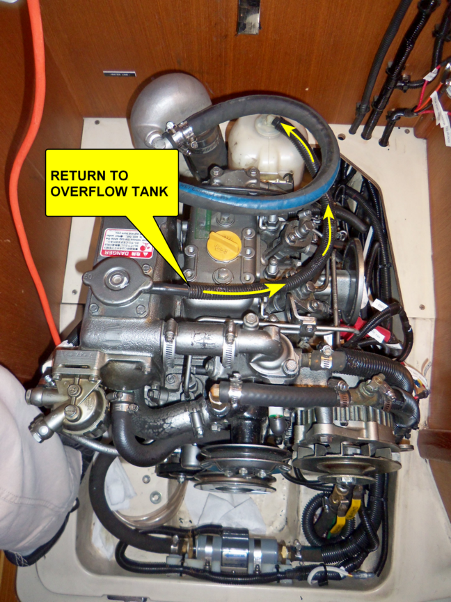

My friends boat is a 2009 Beneteau 30. It has an approx. 5 gallon hot water tank that is heated by 120vac shore power and the anti freeze line off the heat xchanger. We can run the boat under load at the dock for hours and have no coolant leak. We go out sailing and the bilge is full of antifreeze. Seems like the stuff is coming from under the pan, thru the limber holes. I traced the line back to the engine checking all the clamps for security. All tight. The over flow container is secure so that’s not causing it. I’m not sure the previous owner even used the hot water system. I’m baffled. Anybody have any suggestion. This is driving us both crazy. Water heater is under the port side settee.
Has the level in the overflow container dropped OR put another way, have you added any AF since this problem in the bilge appeared ?

* I thought the pan might be full of antifreeze from a previous situation, but the quantity of the antifreeze in the overflow tank flow shows a loss of coolant.
* My friend tells me this happens every time he goes out. Especially when sailing.
* Overflow container was checked and it is secure.
* I think we can rule out the water heater, as there is no residue at the hoses or on the shelf were located.
? What could be wrong with the pressure cap?
? How do you do a pressure test, what do you need, and how is it connected?
