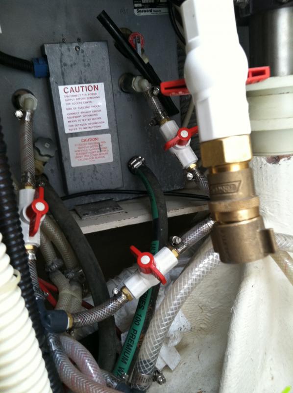

Here is the water heater bypass for the fresh water plumbing side in my system. Works well and keeps the antifreeze out of the heater.
