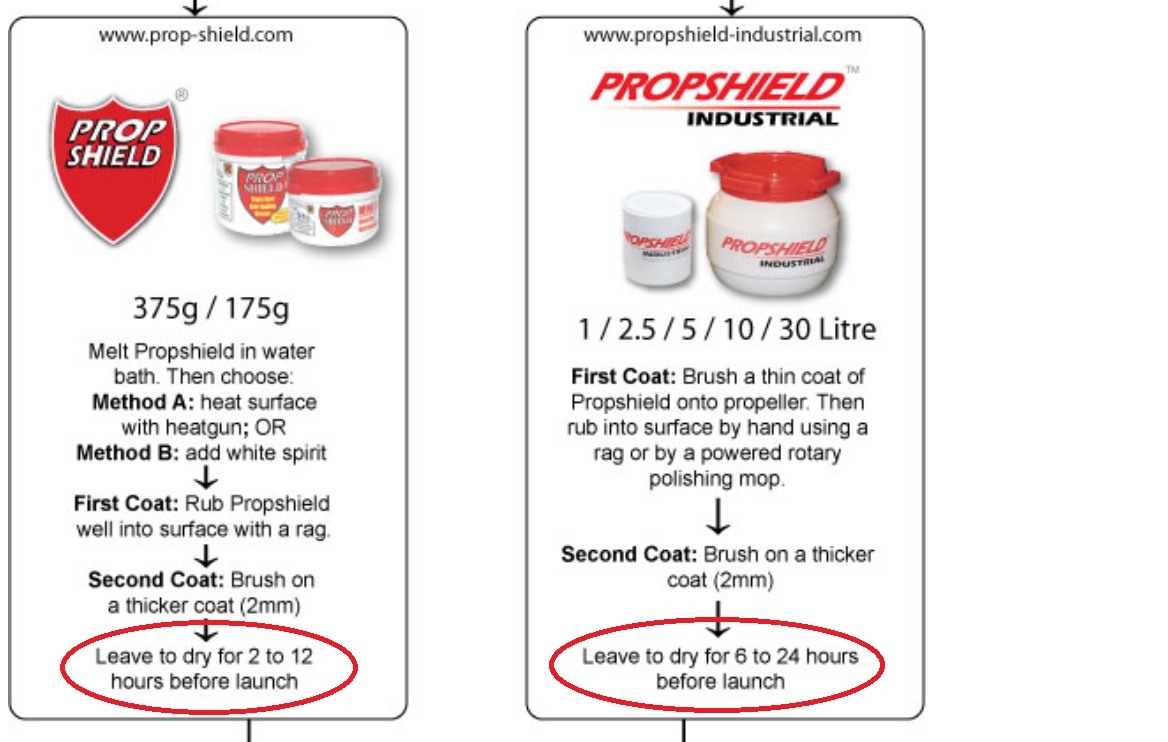

Using a sponge (dish washing kind) rub Propshield wax on the prop & shaft.

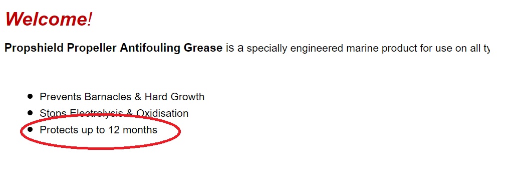

Looks like the mfg. wants this stuff to dry for a few hours before launching. Not too good underwater.
Mind you, I must admit the mfg. is honest about the life expectancy of the product:
Five minutes is "up to" 12 months. Like a lot of advertised guarantees.
