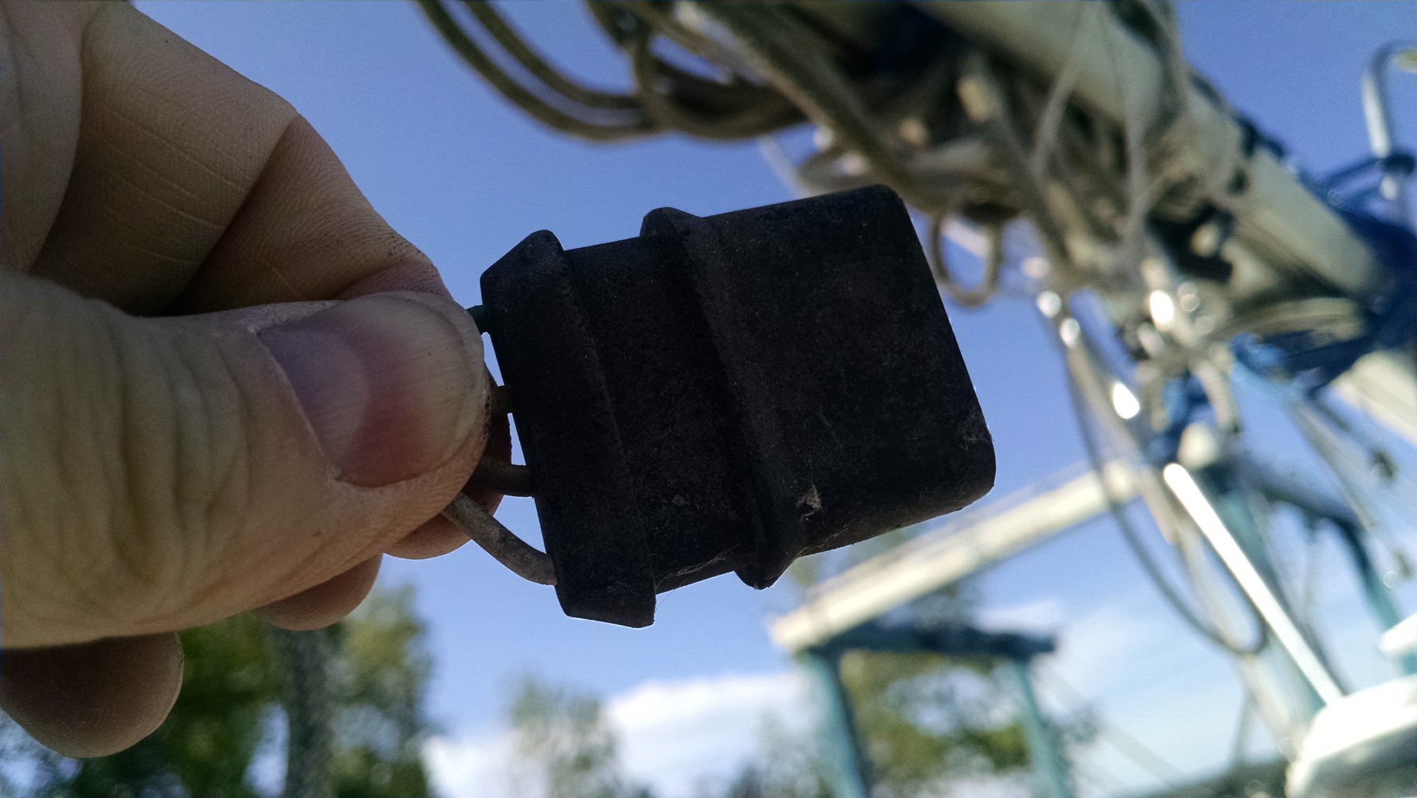

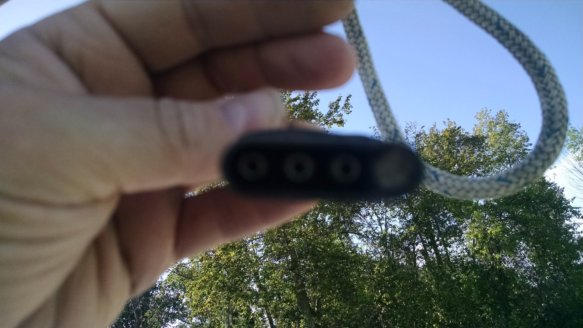

I was looking for the old panel. I think my husband convinced me to throw it out. It had five switches, the center switch was a three way toggle switch and was labeled anchor(just as you describe Crazy Dave Condon). The other switches were running, steaming, accessory, and cabin lights. The deck plug under the mast has a red wire a green wire and a black wire and a coaxial cable for the antenna going up the mast. Below the deck the wire harness has a red wire a green wire and TWO black wires and a heavy #10 wire (the mast ground). Some of the switches had been rewired and I thought just putting each one on a separate switch on the new panel with all two way switches would solve the problem. I would just have to turn the switches on and off manually, rather than relying on the wiring to prevent running and anchor lights from accidentally being on simultaneously (which I am sure is what the original wiring cleverly accomplished). If what you are describing Crazy Dave Condon is the original layout for the mast light, someone at sometime did switch the anchor light to an all around 360 light at the top of the mast, and installed a 225 degree light to the front of the mast just below the spreaders, or they left the combo anchor-steaming light at the top of the mast and added a second steaming light half way up the mast, wired into the old combo anchor-steaming light to have both parts on all the time, but messed up the wiring either in the mast or at the switch or both, leaving me with the current setup. I guess I will pull new wire next time the mast is down. We did have the mast down this summer, but I do not recall anything unusual about the light. We were busy fixing the mast head sheaves.

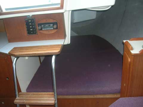

Thank you for posting pictures. On my 26.5, a previous owner has installed a second switch panel where you have your audio system installed. My second switch panel controls things like VHF, Sound System, Depth Finder, Chart Plotter, etc. They appear to have been all added as later accessories.

That is the best photo I have of the plug. Since it is now again snugly under the mast, I cannot get a new photo easily. Now that you mention it, it does look like a trailer hitch plug, although my previous trailer hitch electrical experience all involved wire nuts and electrical tape. So are you saying it is not original equipment? :) It seems to work fine.

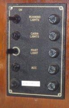

I think I threw out the old electrical panel. Here is one that seems identical except for the labeling. Mine was labeled (from the top down) Running lights, Cabin lights, Anchor lights, Steaming lights, ACC. The Anchor light label was on a three way switch. Steaming light label was on a normal two way switch.
It is a clever idea if at one time the mast was wired so the anchor light could not be on if the steaming or running lights were on, but if this was the original idea, more recent modifications have messed that up.

You are correct that is not original. How about a photo of the deck around the base of the mast. I need to see if there was ever a deck plug there.
