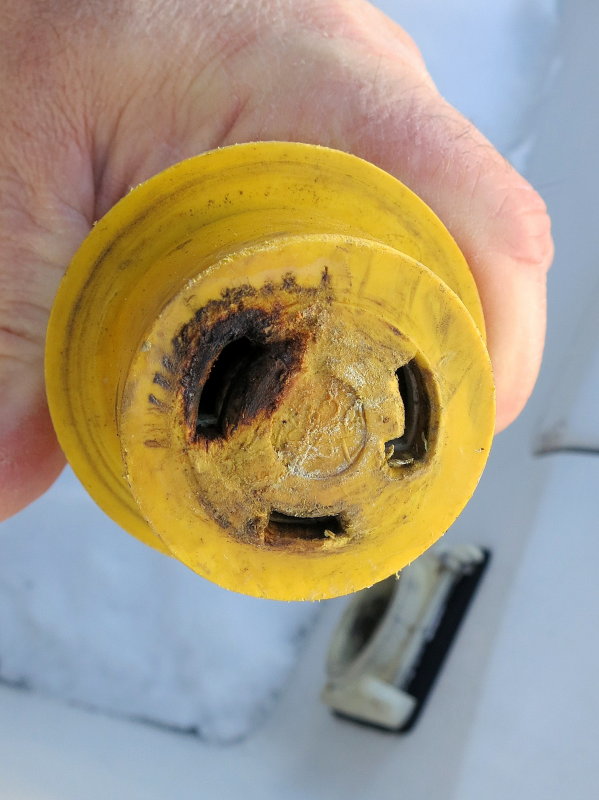

The AC power cord is a 3 prong 30 amp cord for power from a pedestal to your boat.
Here are some examples of bad cords from @mainesail ... https://marinehowto.com/hall-of-fail/
These do fail and 2 prongs is not good.
Look at the Smart Plug 30A Boatside Shore Power. 50ft cord with fittings. Best power cord available.
