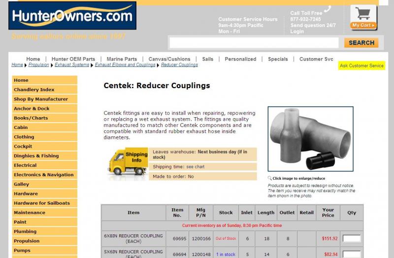

I'm probably reading this wrong, but it sounds like you want to jam the 1-1/2" hose (2" OD) inside the 2" hose (2" ID) and then clamp them together. Not a good idea if this is the intent. You always want the hose on the outside and clamped to a hard piece on the inside.
A 2" X 1-1/2" reducer coupling from the Hunterowner's Store here would be the safe way to go.
Ralph....would you stop making sense and confusing me :) I thought of that too and didn't like the idea of clamping to a semi-rigid hose. I am taking your advise and going with a 2" hump hose and 2" wet hose. I found a straight 2" fiberglass coupler. A lot cheaper than the reducing version. Just need a reducer for the 1-1/2" muffler now. May just find a short piece of 1-1/2" wet hose with 2" od and stick it on the muffler nipple and clamp it.
