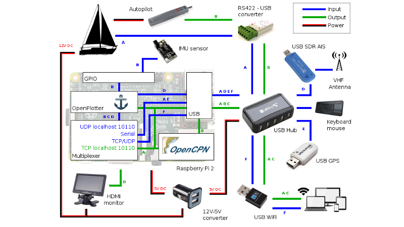

for less than $300 you can have exactly that, RPi3 running open cpn, using free charts, has live AIS, radar input if you have radar, live weather, tides .
And displays on a 7" screen (IP67 protection).
Can you just unbox it and plug it in? no, there is quite a learning curve, but then with something this powerful, that should not be a surprise.
Start your reading here: http://www.sailoog.com/en/openplotter
