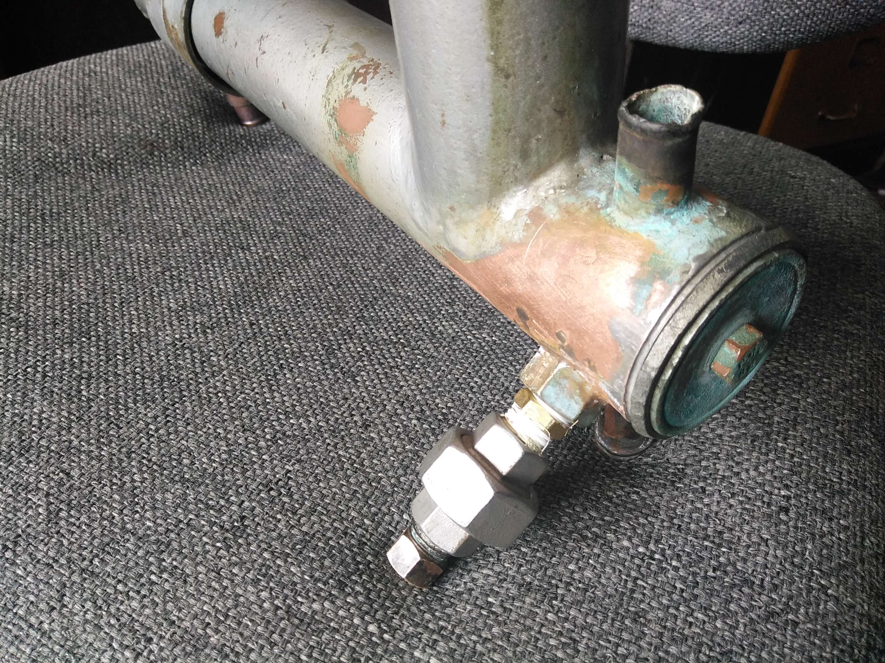

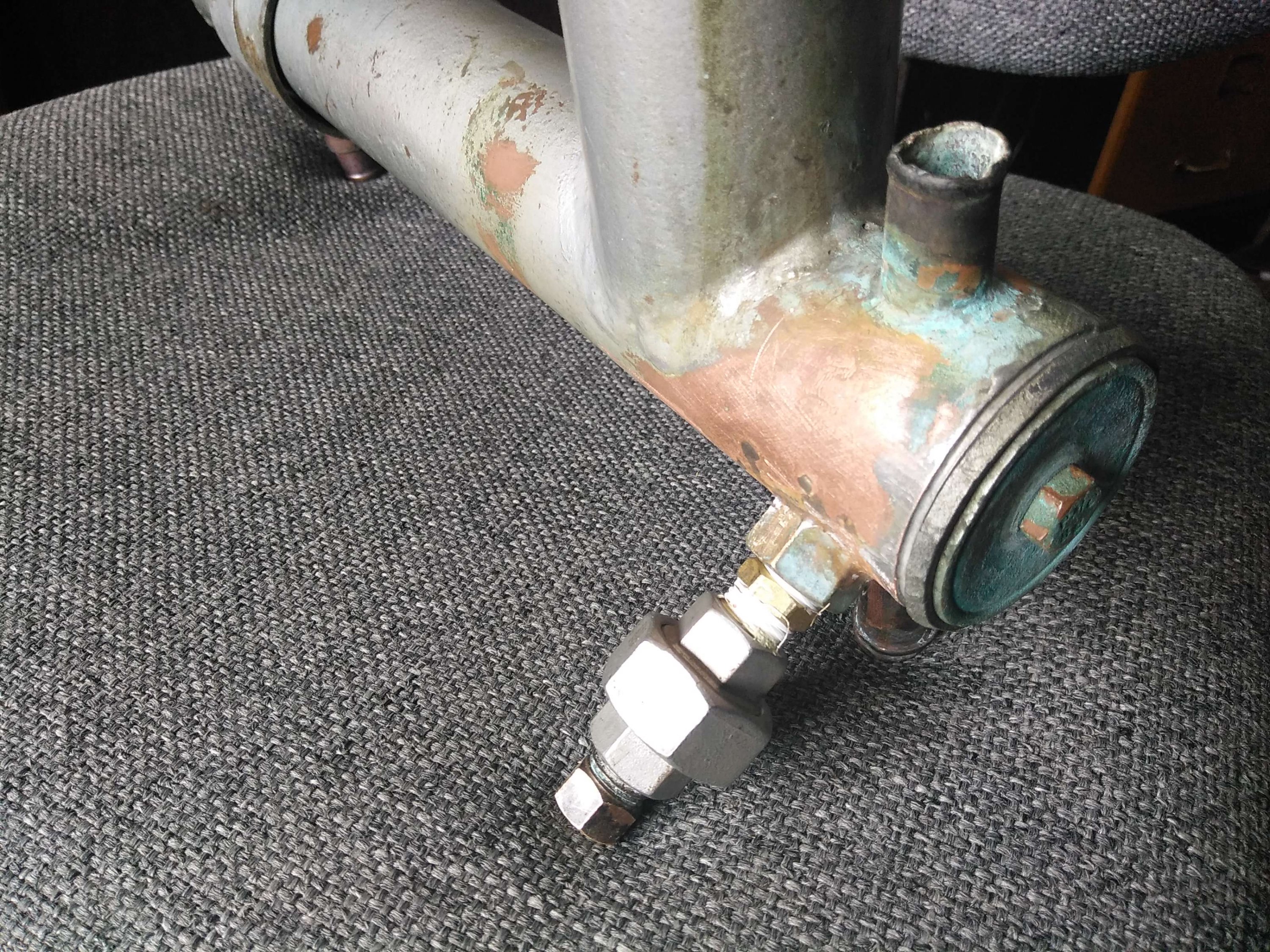

My Sendure 2550 was in a sorry state when I bought my boat in 2007. Exchanging fluid between the raw water and anti-freeze. To troubleshoot, the radiator shop, which also specialized in heat exchangers, de-solderered the end cap on the side opposite the bolt removable end cap. The baffle into which the tubes are spot welded had several micro holes in it. At first the shop declared the exchanger not repairable. But when I noted that the tubes themselves looked great, I suggested that the tech guy flood the damaged baffle with a layer of liquid solder. He did. It worked. So far the repair has held. But I am anticipating the need for a new exchanger at some point.
Attached is a picture of the mod I made so that the zinc pencil remains outside of the baffle area. Also provided room for a longer pencil zinc. Before I needed to cut the zinc down to all but about 3/4". Otherwise it wouldn't fit into the heat exchanger chamber. The union in the mod is stainless. Checking with my ohm meter, continuity between the zinc pencil casing and the heat exchanger body is good. I will check in a few months how the pencil zinc is faring down in the rabbit hole.
