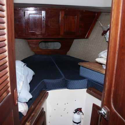

I'm just finishing up a custom holding tank for my 37c. I've seen about 5 possibilities for tanks in the archives and here's another. I have water tanks under the settees in the main cabin, so that was out; I like the idea about putting it in the bottom of the hanging locker but didn't like how long the hoses would have to get. Against the hull under the mattress is also awkward, since the hull gets wider from the bottom up as well as fore to aft, and the original spot is unacceptable. So, to any like-minded folk, here's another option, directly under the aft third of the mattress in the v-birth. Yup its inside the cabin, and you'll lose space, but if you are in my position and need a 25-30 gallon tank (and have water tanks in your settees) I think its a good idea. Also, the space you lose is an empty trapezoid covered on all sides but the front, and is usually wasted anyway--at least it was with me. I epoxied 8-layer marine plyood to waterproof the sides, epoxied the corners once put together, and then glassed it all around for strength. If anyone wants, I can give more details, but just wanted to toss this option on the pile for dealing with the holding tank issue. A question also--a 1.5 inch hose won't fit back between the hull and the back of the seat in the shower--in order to go from my tank to the deck fitting. I found an old 1.5 inch hose that was cut, so I guess the previous owner took out the tank and the hosing but couldn't get it all out--and neither could I--but I don't know how they got it in in the first place. Has anyone else found this; it's bizarre and must be the only spot to get a 1.5 inch hose through there without cutting into the wall. The space goies right along where the hull and forward-starboard bulkhead meet (the corner of the v-birth mattress). Josh

I don't have the exact dimensions with me, but just look at the spot where you might kick your shoes before you go to bed--I think Ed S. called it the changing area, anyway the trapezoid that's still in the cabin, under the aft section of the v-berth mattress. My tank is precisely that size. As far as the Lectra-San, I looked into those; you actually recommended them to me a ways back, but they were just too expensive. Also, my harbormaster informed me that they are illegal in some spots already, and will be illegal in more soon. Whether that's true or not, it doesn't get me past the cost issue.

I think the picture shows where Josh built his tank. He filled in the area of the v-berth where I stand to make the bed and put on my PJ's. Right where the fire extinguisher sits. It is still not clear to me why he did not put it inside the v-berth locker. As I have reported(with pictures) there is easily room for 30 gallons in there. My own is 22 gals. and the locker is only 1/3 occupied.

Thanks for the pics Ed, you are right about the spot. In my v-berth though, the spot was already covered with plywood to make one large bed. I will put pictures in the pic gallery tonight or tomorrow. I took them this morning, but left the camera in the car. Be careful with those Ronco tanks for the v-berth locker, it's definitely possible I missed the one your talking about, but the fact that the hull gets wider both fore to aft and bottom up makes for an extremely difficult fit for a trapezoidal tank. Good luck everyone. Josh

Josh, is the box the tank
or is there a plastic tank in the box? Scott
