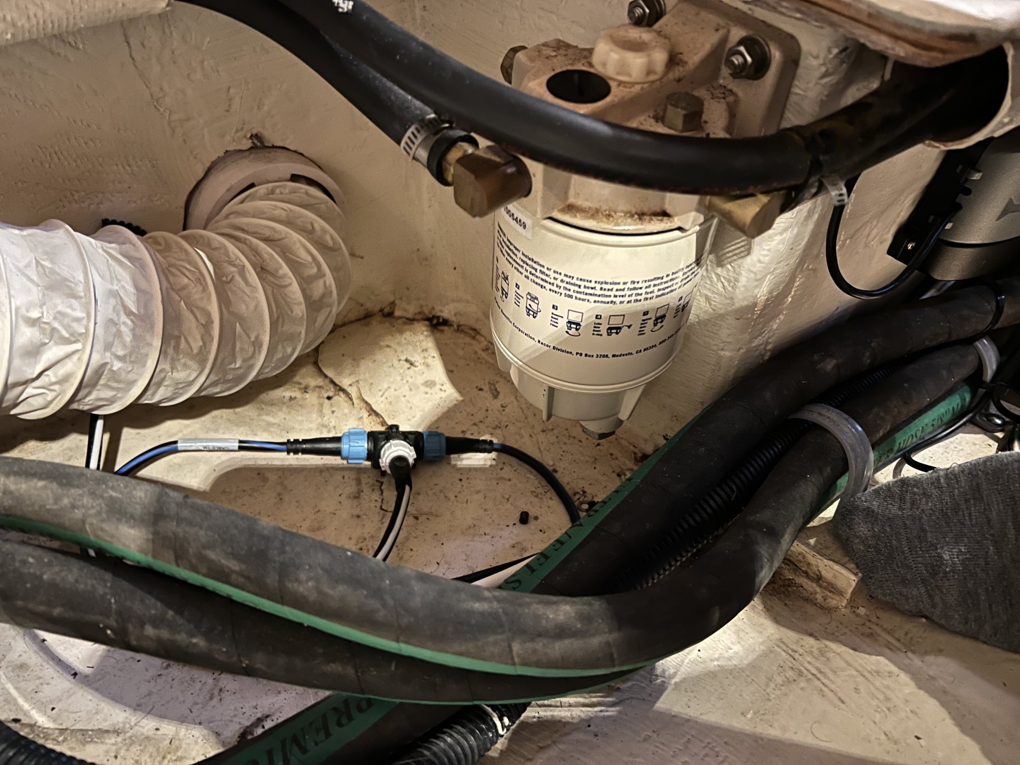

You wouldn't necessarily have to mount the Racor in the engine compartment. My C310 had it mounted under the aft bunk, aft of the muffler. It had good access and freed up the area in the engine compartment. You could even leave the existing filter in place for additional protection.

I upgraded to a Racor 500 knockoff, Turbine Marine Boat Superior 500FG 500FH,
$37.00 on Amazon. It uses the same filters and appears identical. That replaced the Racor 110 that came with the boat. I still have the 110 in the garage, for postage and $10 its yours.

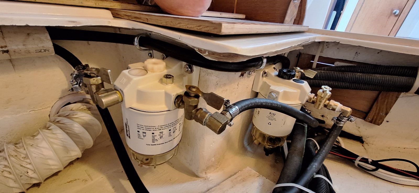

Hi, after my fuel tank became contaminated with bio crap and clogged my fuel pickup (required a tow in) I decided to replace the tank and all hoses. Then I had the bright idea of installing another filter in line so I could operated on either filter while changing the other one. I now am very careful about my fuel. I add Biobor JF each fill-up. Tank was difficult to install and expensive btw. I am now thinking about making a cheap fuel polishing system using the knock off filter.
