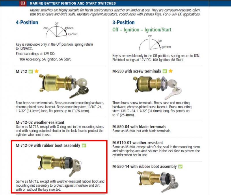

Jan 4, 2006
7,822
The only pain will be finding a waterproof key switch that'll fit the Yanmar panel
And (of course) warmer temperatures...
Chris
Take a look at marine switches under section C3 in the attached catalogue.
The one I used was the M-712-09. I don't know if you'll be lucky enough to have one of these switches fit your Yanmar panel.
Here on the Wet Coast, we're just waiting for drier weather.
Good luck with the switch and a Happy New Year.
