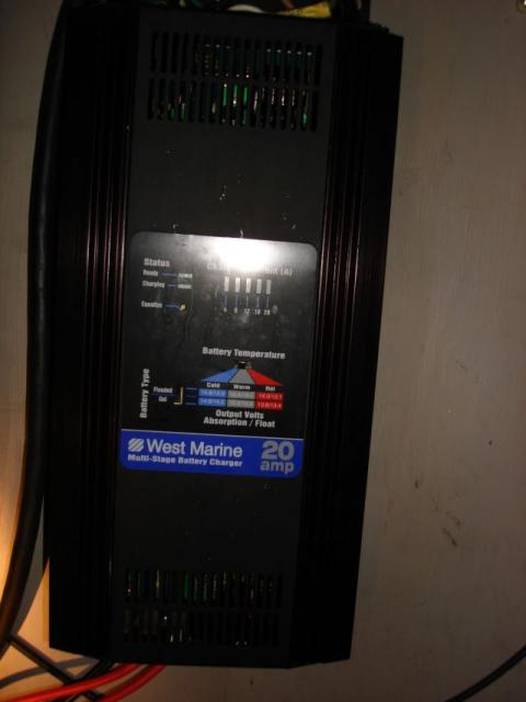

I was able to visit the boat this morning and took a picture of the charger. I was a little off with the original description but not by much. Can anyone give me any specific info about this charger?

Looks exactly like my Truecharge 20/40 except the case is black WM and not yellow. It has a battery type switch, an ambient temperature switch, a hidden pinhole button to synchronize (can't remember what they call it when you really over charge the battery to bring all the cells up to charge) all the cells. It also has a 20 day timer that does that too as long as you don't turn the unit off so watch your water levels. It is a true 3 stage charger
Try
http://www.xantrex.com/support/web/id/998/support1.asp
should be one of them you can ID from the front panel. WM does not move the components around just has them painted a different color.

Gary - It is a Xantrex Truecharge 20, an excellent three stage charger, previously built by Statpower. They were painted black before the newer Truecharge + series was introduced. You can download the Truecharge 20/40 + owners manual and other info from:
http://www.xantrex.com/web/id/69/p/docs/pt/7/product.asp
The only differences between yours and the + series [IIRC] are that yours is for two banks, not three, and you don't have the constant 13.5 volt setting. Oh yes, and yours is not yellow. ;)

Thanks to all of you for identifying this for me. The .pdf manual should help me also.
