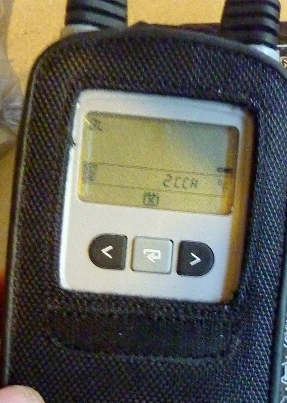

Last fall the batteries tested nearly perfectly, considering the age, and they put up 710CCA on my analyzer. Today they measured JUNK at just 2 CCA.... The battery cases are bulged, the positive posts are bulged and the batteries had a couple inches of exposed plate... They were chronically over charged...

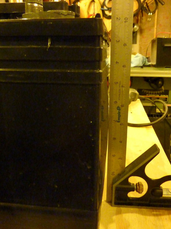

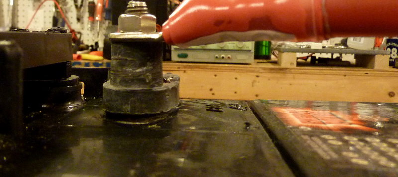

I'll upload some pics of the destroyed batteries soon...
This bulge around the positive post was not there last fall:
The cases were fine last fall:
Last fall these batteries were still capable of 710 CCA, today just 2 CCA........

What causes the bulging? It's not like they're sealed and pressure can't escape.
It s likely the positive plates buckled after losing enough electrolyte while still being fed high voltages.. Plates can physically grow in size due to corrosion of the grid. As it has been explained to me the lead dioxide, which can result from over charging, takes up more space than the grid plate lead that originally formed the plate.
I rarely see bulging in chronic undercharging but do see it occasionally in cases of over charging, especially when there is a large loss of electrolyte as was the case here.
Cases of chronic over charging are much more rare these days than they were years ago. Most battery failures I see are from chronic undercharging not over charging... In fact the last two over charging failures I've seen have both been from un-regulated solar left unattended for long periods of time. One was a bass boat with a bank of two trolling batteries and this one a sailboat stored on the hard...
I would have to guess these batteries have been subjected to a few hours of 14.6V - 15
V+ every day since last October...
