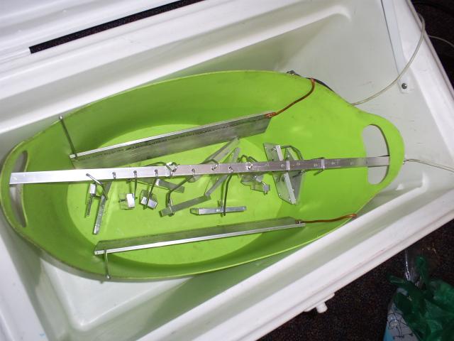

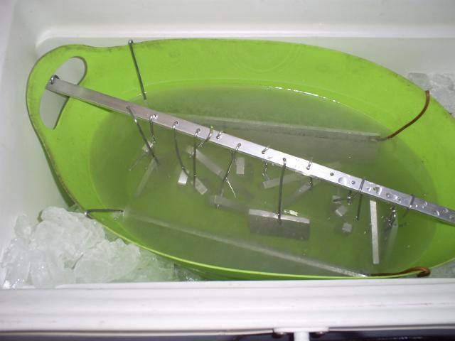

I have a tub inside a cooler, because anodizing works best around 65 to 70 degrees Fahrenheit, and the process causes heat. So I will put ice in the cooler and the tub sits in the ice.

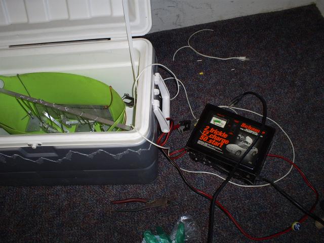

The bar running in the middle that all the parts are hanging on is the anode and the positive battery charger cable hooks to that. Wikipedia says that's why it's called anodizing because the parts being anodized are the anode.
The two long plates along the sides are the cathode that the negative battery charger cable is hooked to. They say it's best to have as much surface area on your cathode as you do on the anode.
I have harvested 3 large sized mason jars of battery acid from two old batteries that came with my boat. I was concerned that it lost it's acidic properties because it sat so long, but I spilled some on my sandal wearing foot, it turns out it's still acidic.
All the metal that will be submersed in the electrolyte is 6061 aluminum. I have read you can use stainless for the anode, but it's way harder to cut to size so I went with aluminum.

All these parts are to a triple clutch I made for 1/4" lines. I had bronze bushings pressed into the cam arms but it seems to be a bad thing to have any other type of metal touching your to be anodized parts, so I took them out for the anodizing. I also had a solution of aluminum brightener so I cleaned my parts with that and rinsed them in water before putting them in.
It's all set up for tomorrow, it's 3 am and this will take 2 or 3 hours to complete. So I will post the results when I get around to doing this tomorrow.
