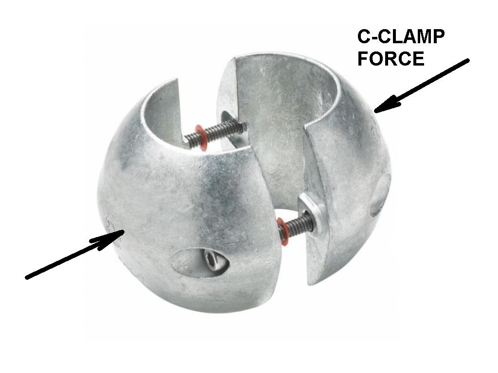

I like to see it two finger lengths from the strut. This limits unbalancing the shaft, especially long shafts. It minimizes shaft whip when the anode wears unevenly..
If you were doing TWO on a shaft, I assume you put the other as close to the shaft tube as you can?

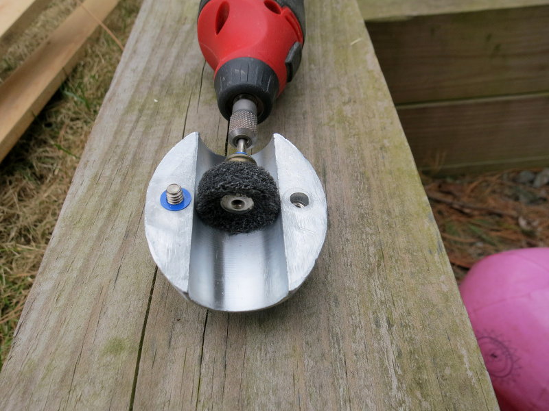

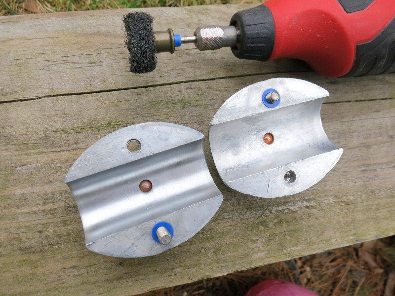

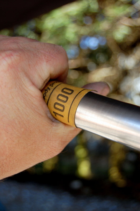

Finally, as a follow-up to post #50, I replaced my bilge pump wiring and also replace the battery charger with a Pro Mariner. I may have had a ground issue there as well. Also added a third zinc (probably the biggest help). Also have heard that the fast tide flow thru the marina can contribute to zinc wasting. I have to replace two of the zincs at about 4-5 month intervals, which is probably about right. I polish the inside of the zinc and polish the shaft as Mainesail shows earlier in this thread. Interestingly, with the three, 1" egg zincs butted to each other, and with the aft zinc an inch from the cuttless, the two end zincs consistently waste faster than the middle one. I have a 3-blade bronze prop on an aquamet 19 shaft. So the middle one gets changed every other time. They seem to waste faster in warmer water, but that may be my imagination.

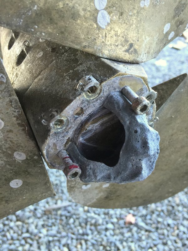

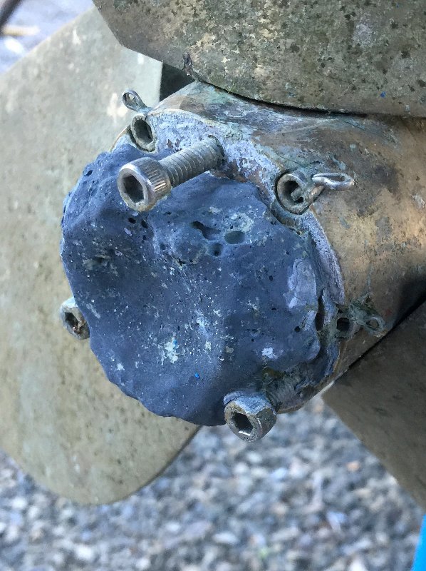

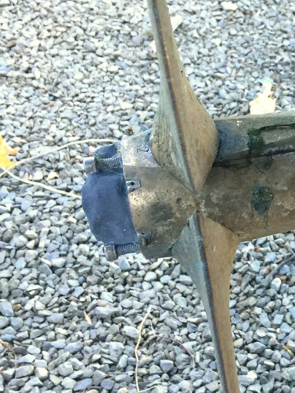

I inspected my new boat and found severe erosion of the hub-end zinc on my Max-Prop. The zinc was brand-new on Sept. 1, boat launched and then sailed to my new home port, at a mooring only until about Nov. 21. About a dozen hours of battery charging from 9/8 to 11/21.
I was shocked to see that the zinc is almost gone. All that remains is a ring suspended by the attaching screws. There are two zincs on the stainless shaft, one eroded a bit, the other not much at all.
Any clue as to why this would happen?
