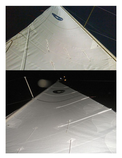

Last year was my first year sailing 'PRONTO' and I didn't think the old main was too bad until I got my new main at the end of the season. She sailed OK with the old one. Just OK. Really looking forward to this year. I was only able to sail her a few times with the new.
Old
New
