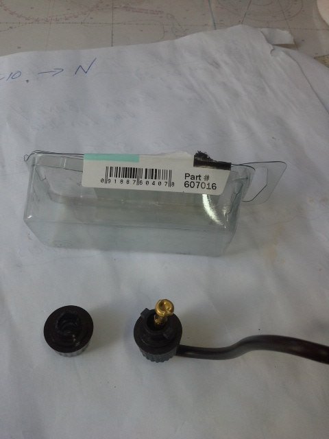

My latest complaint is the Ancor In-Line AGC / MDL Fuse Holder 607016 they stink. I have had 4 fail. All purchased from separate sources on separate dates.
They protected important circuits: Start, solar panel, bilge pump and Blue Seas 7610 battery combine.
I contacted Ancor and they denied there was a problem.
If you are using these fuse holders on an important circuit without exception, make no mistake, I suggest you replace it. My new go to fuse holder is Blue Sea Systems Waterproof In-Line ATO/ATC Fuse Holder.

What's the nature of the failures? Any photos?
Ancor generally has decent stuff, so I'm a bit surprised.

Kind of a thin indictment without any specific claims or evidence. Can you please describe the failures? Pics would help, too.
I have purchased similar fuse holders; some were pure junk, others were beautifully made and engineered. Avoid no-name ones from China, buy brand-name ones from US sources. I'm not sure if Ancor is actually manufacturing these or just packaging them.

Thanks for the pic, Nick. Looks like the plastic barrel broke? Wow, never saw that before. I just looked on mouser.com, name-brand, inline, waterproof fuse holders can be expensive!
Apr 15, 2012
36
Catalina 400 Milwaukee, WI
I've had the exact same issue with the same exact fuse holders, in fuse holders that were about 2-4 years old, for about 3 fuses. Each time the failure occurred during winter storage, so I wonder if cold Wisconsin temperatures had something to do with the plastic getting brittle.
As a countermeasure, two years ago I began the practice of removing the fuses from the fuse holders during out-of-the-water winter storage. When the fuses are removed, the plastic isn't under any spring loaded strain, and may be less likely to break. So far, so good, but it's only been two years so my results aren't scientific. I also have to carefully label or store them so as not to reinstall the wrong amperage fuse in the wrong place.
