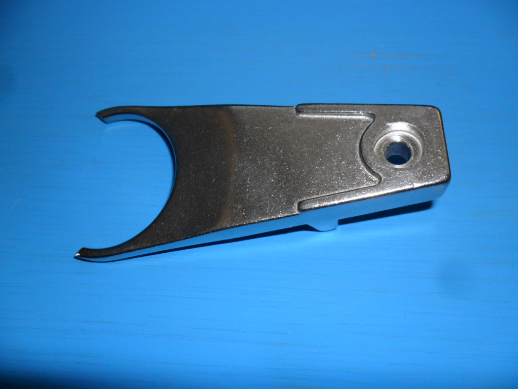

An update on my Anchorman Sprint 900 windlass repairs:
1. I was eventually able to remove the drum. PB Blaster, heat, and light taps/prying with a hammer and a couple of screw drivers eventually got it off. However, I was never able to remove the gypsy. It looks like there are two pins between the gypsy and the cones that "lock" the gypsy into the center shaft. I couldn't get those to slide out, and eventually ran out of time. Which brings me to the other part of my original question:
2. It turns out the Sprint Anchorman 1500 fleming is the same size as the Sprint 900--however, the gypsy on the 900 doesn't appear to disassemble into two pieces which, I believe, is why the original 900 flemings were a split-plastic piece that could be wrapped around the gypsy.
I purchased a Stainless 1500 fleming from Crowleys.com
I then modified it with a sawzall to remove the ring to look something like this:
I was then able to slide the open ring around the center of the gyps and screw everything down. Quick test shows that it works like a charm.
A little grease on the drum (to, hopefully, keep it from seizing to the center shaft again) and we're back in business.
