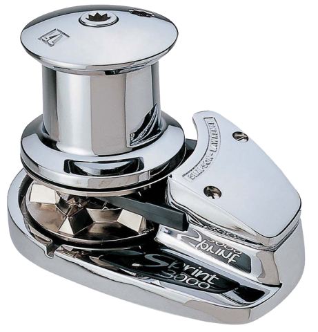

Interesting. Mine looks something like this:
On my unit the cover on the top/right side is what guides the line down into the pipe. I tried running with out the cover, but the rode did not seem to feed properly (I didn't try it with the chain portion of my line).
Doug
