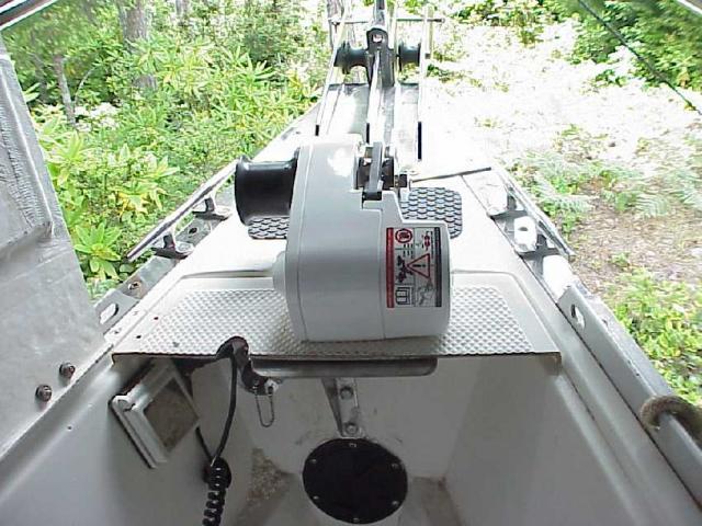

Re: Mel, here's a pic of...
Hi Dan,
If your project is for later in the year, Ill be able to help with pictures. The boat is under tarp, on the hard, in Montreal, and I am in Florida until March.
The pictures are unfortunately in my home computer. I did an installation similar to Fred, but did deepen the anchor well rather than cut the bottom off completely like Fred. Works well with 75 ft of 5/16 grade 40 chain spliced to 150 ft of 9/16 rope. Lewmar windlass and modified anchor roller allow me to drop the hook (Bruce 39 lbs) and retrieve it from the cockpit control.
As I said, if you can wait until March, I'll be able to help. Let me know. good luck
