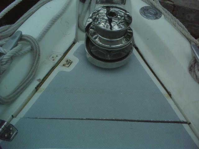

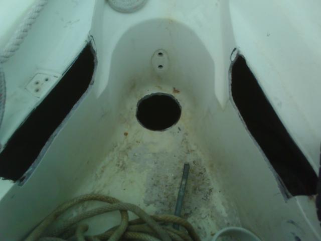

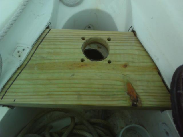

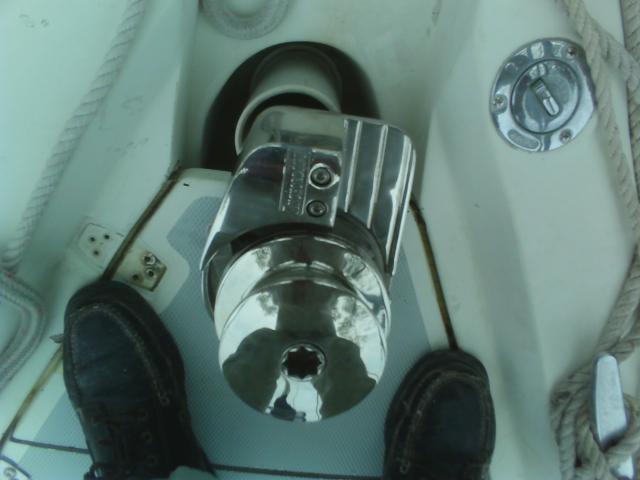

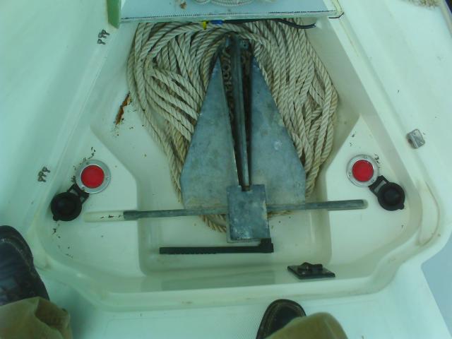

installed a Dolphin 1000 on my Hunter 336, cut the anchor lid, reinforced it with a PT 2"x8" cut into the hull, use the existing locker for an extra anchor, rode & chain, ran rope & chain into a 3 1/2" PVC tube into the bottom of the boat, in front of my fresh water tank, can get 100' of rope & 30' 5/16 HT chain to crank in automatic, added a bilge pump & tru hull fitting to purge any water that gets into the PVC, battery also to run the winch & pump. Added foot switchs in the anchor locker, + cockpit switch on the wheel pedistal.
