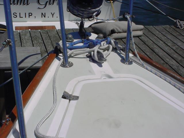

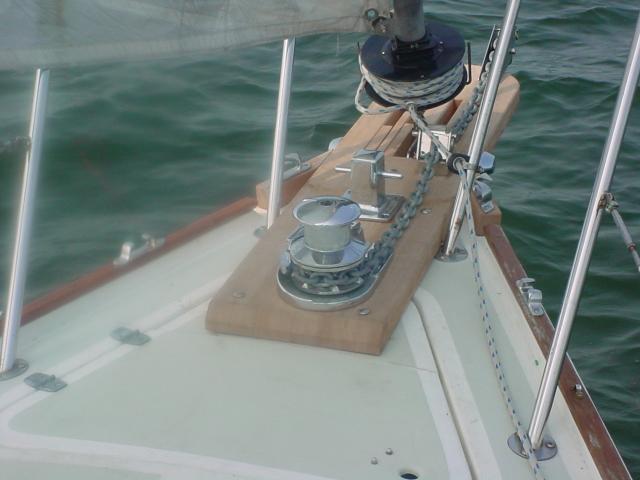

Here's some pictures from my installation and I bought the next size up unit and the difference in price wasn't too bad.
If you look close you'll see I cut the cover for the anchor locker and I also installed a unit that has a horizontal motor because space was tight underneath and also instead of foot switch's to control it I install a pendant control (similar to a hoist controller) and it has a 5 ft cord on it in addition to the control at the helm thats so convenient
I also chose the type with an additional drum and have used it to hoist the bosuns chair up the mast, same thought difference in price wasn't much more.
Don't cheap out on the supply wiring! make sure its large enough to carry the load and figure for voltage drop all to often I see installations that don't work right and its because they didn't want to spring for the heaver wire

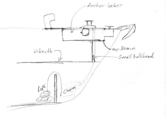

BTW the sketch was from this site and it turns out it belongs to a 37 ODay owner that also has a similar installation
