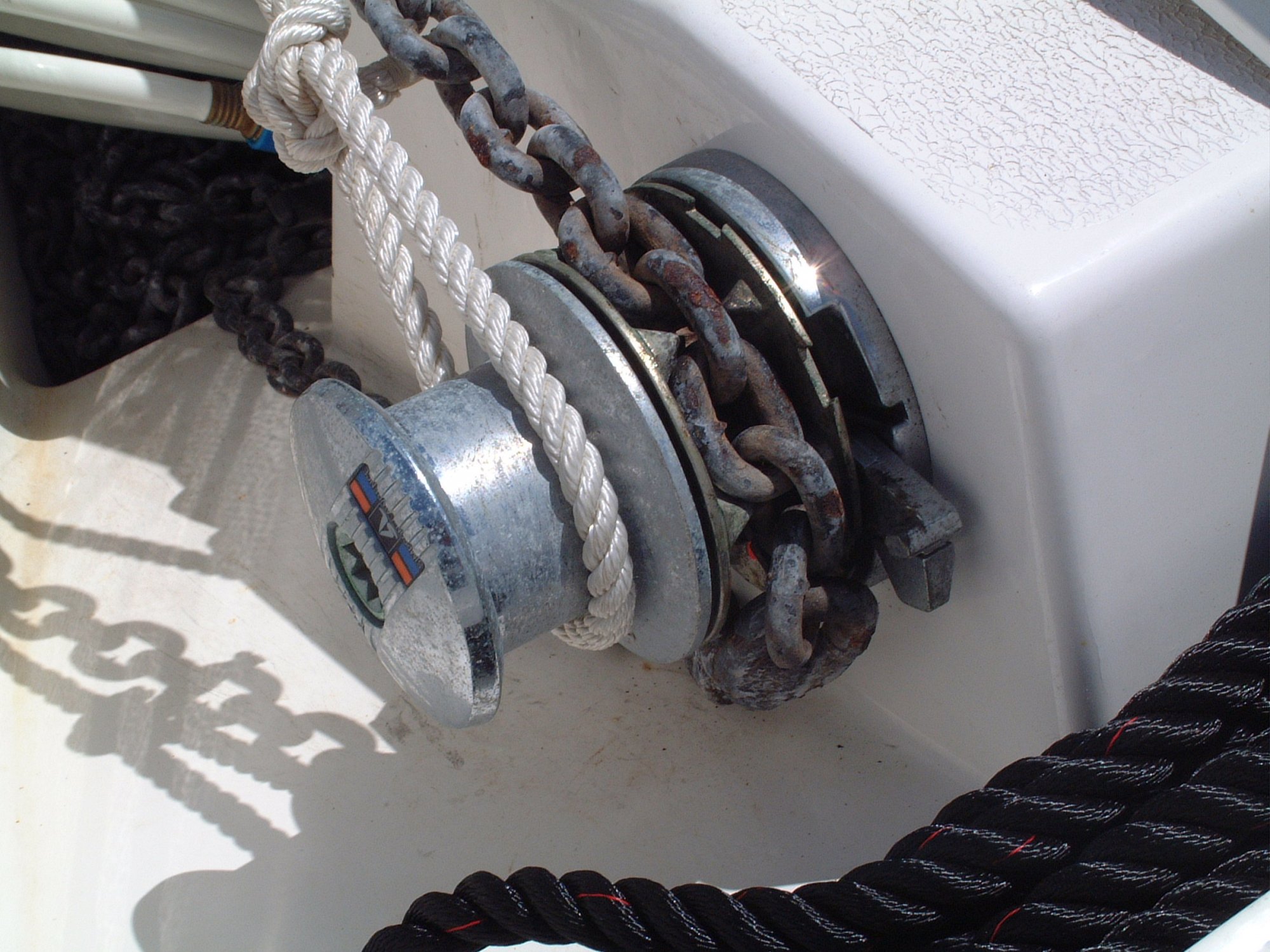

I don't know what your anchor locker looks like but we have a vertical Simpson Lawrence (now Lewmar) mounted horizontally in our locker.

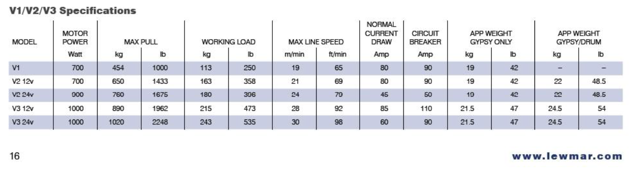

All theatrics and histrionics aside, NO this has nothing to with friction on the drum as opposed to a gypsy. Look at fig. 7 on page 7 of my attachments in post #3 above.
I refer you to the V1 which I installed on my H-310. We see a MAX PULL of 454 kg. This is in the locked rotor state of loading the electric motor. This is what I told you to study. It is of no practical use. The rotor is supplying enough torque to support a load of 454 kg. but will not lift a load of 454 kg. The windlass motor is about to blow its fuse. Learn how to use this figure.
But anyway, why not address the point of my original post - in general terms, why not drum winches!
Because it is highly unlikely you will ever use the drum section. Not to mention that swapping the rode from the drum to the gypsy during a lift can be a real finger mangler.
