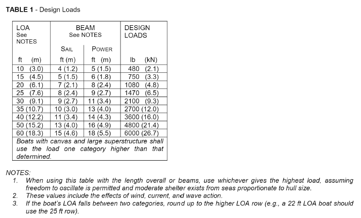

Just tonight I was being asked about anchoring systems and I pulled up H40 "Anchoring, Mooring, and Strong Points".
If you need a swivel, then you need to look at the required design loads for your boat - you state a 32 foot C&C.
So your design load would be 2700 pounds as you see in Table 1 from that standard. So you would look for a swivel that is rated for that loading or higher.
