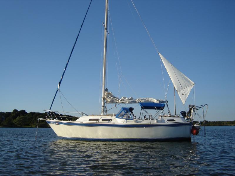

Anchor Sail = plus one!
We cured our boat of wandering back n forth at anchor with an "anchor sail". It's small, and the long side is tight-sheeted forward along side the boom. The shorter side is clipped to the backstay and "hoisted" with a spare halyard.
Works just like the fletching on an arrow.
Local sailmaker made ours, and you can DIY and order up a kit from Sailrite.

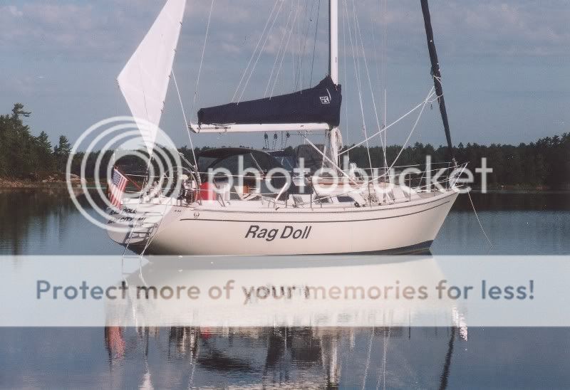

Hey, I thought that anchor sail looked familiar - we have the same one. Made, if I'm not mistaken, by Kent Sails in Michigan.
In fact I wrote an article featuring that anchor sail for Good Old Boat Magazine a few year ago.
http://www.goodoldboat.com/reader_services/articles/horsing.php
As for wind speed, that was never an issue, and we kept it up in all conditions. It worked great, and I would never be without one. And I agree that it was a great way to meet people, as they were always rowing over at the anchorage to ask about it.
