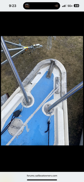

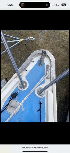

Fred. Pictures of your bow from the windlass to the bow. And a side profile image.
Aug 17, 2013
1,090
Pearson P30 202 Ottawa/Gatineau

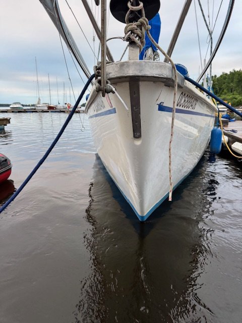

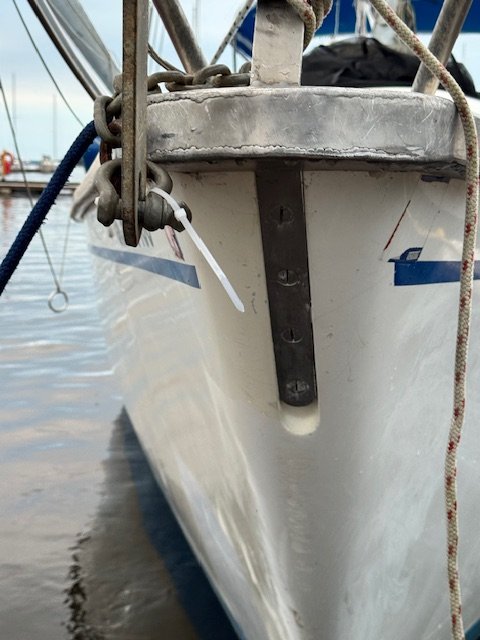

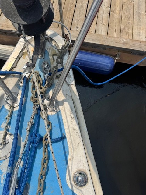

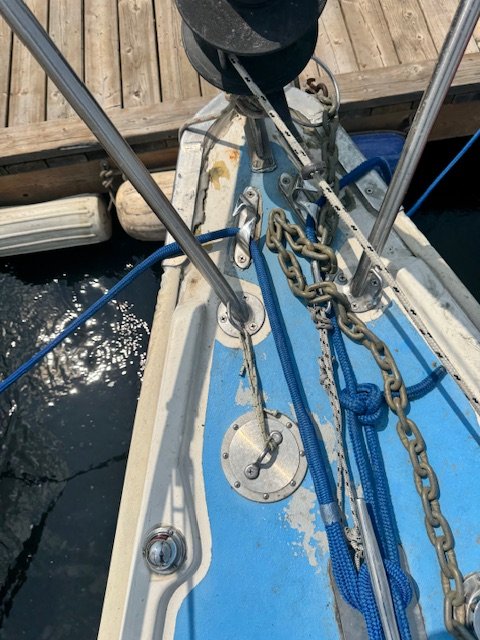

I found an old picture of my bow when I needed to replace a chock.
This gives a decent idea until I go take pics this evening.
I am wondering if I should leave the chocks and center cleat or replace the chocks with a cleat either side? What do you all think maybe move them more backwards? To give me more room for a roller?
for reference, I do have a furler, the anchor is a Danforth, 30 ft of chain and 150ft of rode
The only mod to the pic is both chocks are in place and I added a decent closed hawsepipe (or whatever you call it) for the chain and rode
Aug 17, 2013
1,090

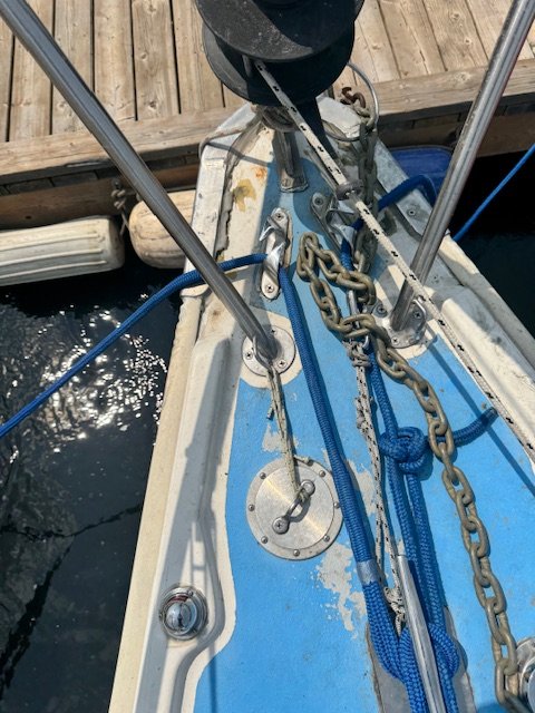

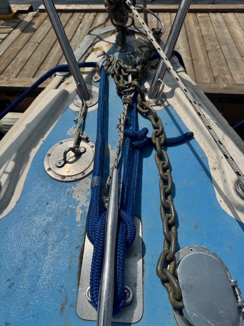

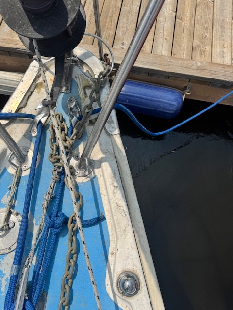

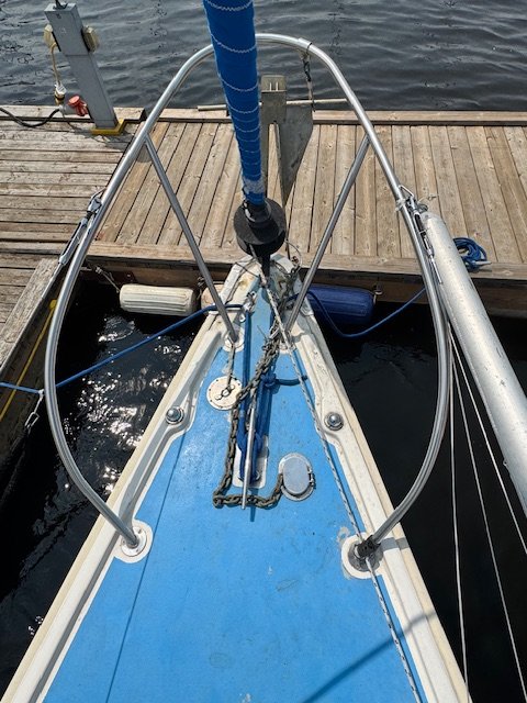

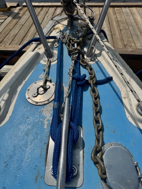

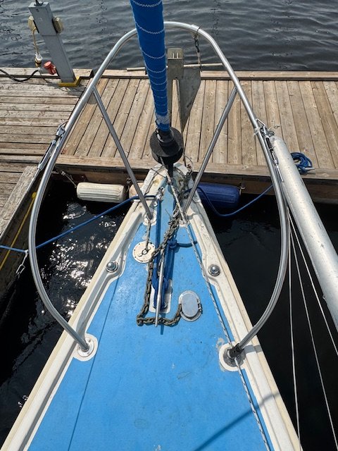

Ok, finally had time to get pics, what I am thinking is moving the chocks back installing them on a wodden Block or other, filling the holes back and installing the roller angled (furler in the way) pointing port side.
I am looking at different styles of rollers, I like the long ones as they can support the anchor when on deck, or should I go with the short ones and still get the pullpit to hold the anchor? I am afraid that with the short one, the screws might not have enough room

Angling the anchor roller to the side is going to put it under a lot of side forces. Most rollers are set up to deal primarily with longitudinal forces. Having it angle off to the side will also make pulling the anchor up much more interesting, as the anchor line will be pulling the boat off to port while the boat is trying to lie to the wind. Perhaps a roller that projects from the bow like a sprit would work better than one that rests on deck.
Jun 14, 2010
2,408
You don’t have enough open deck to make that work properly. The chocks and cleats need to be moved aft to the area near where the nav lights are, and then you could replace those deck mounted nav lights with a single pulpit-mounted bi-color light (or simply relocate them farther aft at deck level, but I think the pulpit mount is better because it puts the light out in front of the headsail).
This would give you more working area to lay out the components. You still need those chocks and cleats for dock tie in addition to anchoring. Don’t let the roller extend too far forward, because the lever geometry could create huge dynamic snatch loads that could damage things if you come up short on the rode in waves.

By angled I just mean by a few degrees, just to the port of the furler and ending close to or before center, but I do understand what you are saying.
do you think there would be enough room to install it straight? That would lessen the load problem.
I did think about mounting it out a bit, but I am afraid of the extra load it would make for the fasteners and the deck.
as mentioned above, I am considering moving the chocks back, I need to take measurements to figure out exactly where!
the roller I am looking at is under 15” long, so it’s not that long, but I will double check next time over there.
If you have any other suggestions, please let me know, the more info I get, the better the results
23,776
The pictures confirmed what I suspected. You have an awful lot going on for that narrow bow.
Unless you are prepared to rework your anchor system, I think it is unlikely you can make a simple installation of a bow roller.
The Dansford anchor would not play well on a bow roller. The deck chocks, while great for marina tie-ups, are in the way of the anchor chain Spurling pipe. You can lay a long roller at an angle off the bow, but would need to secure the chain to a bow cleat with a snubber line (taking the pressure off the chain. Are you planning to install a windlass? This would add another complication to the existing system.
Lots to unravel.

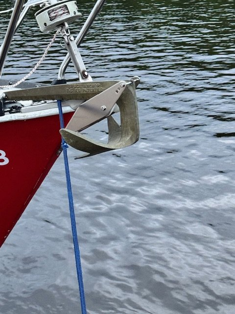

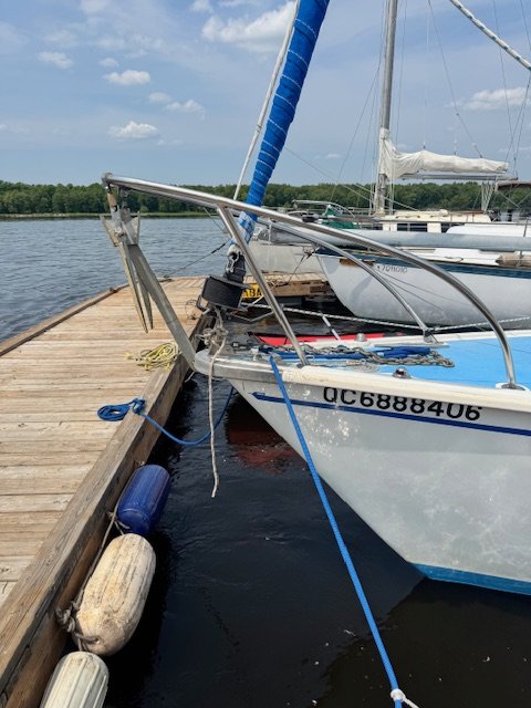

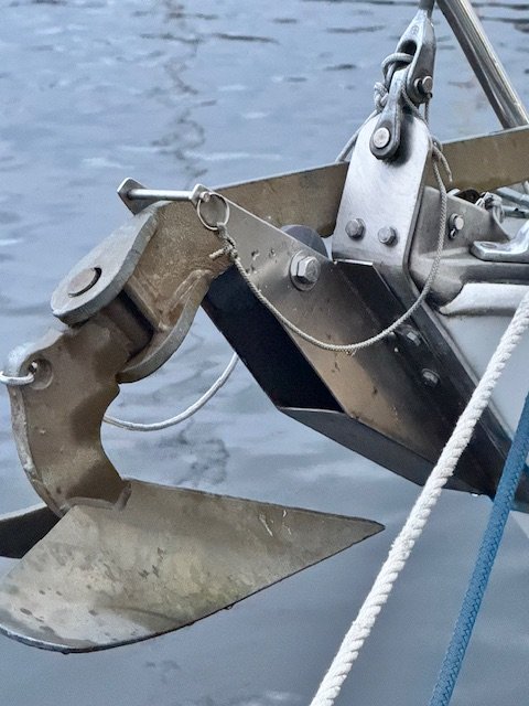

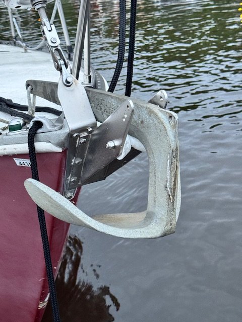

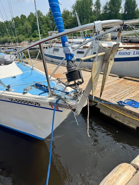

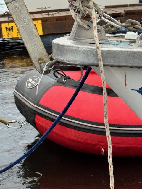

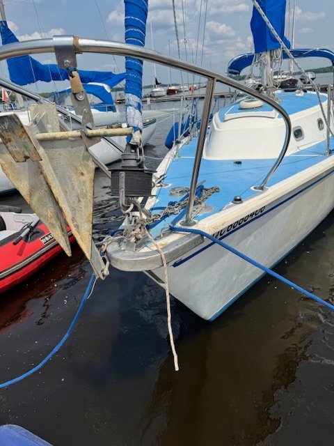

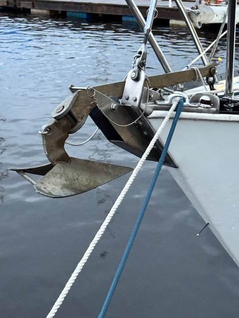

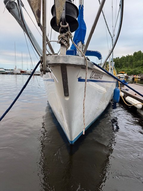

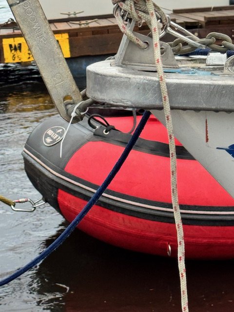

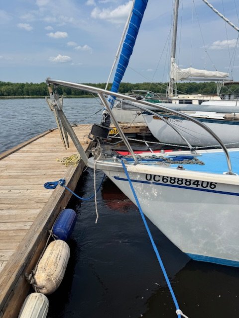

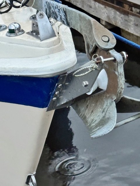

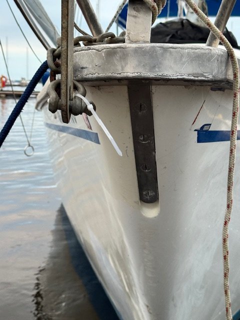

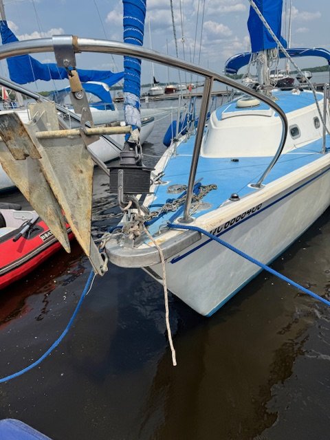

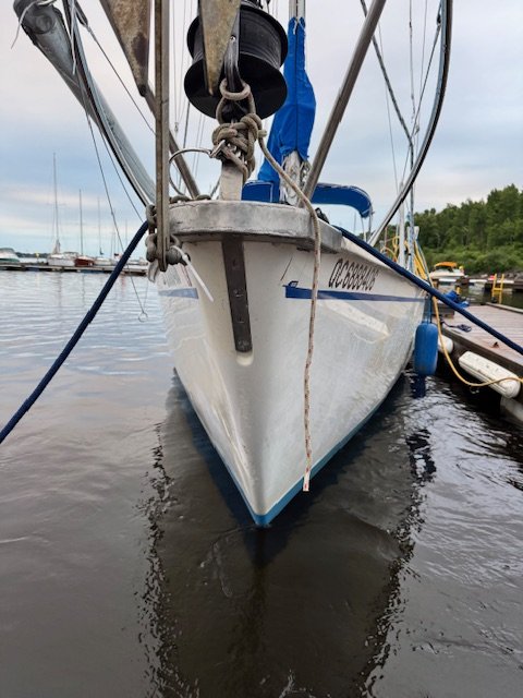

I just had a walk at my club, saw a few boats with the roller mounted on the bow’s nose, I think this might work for us.
I will post pictures

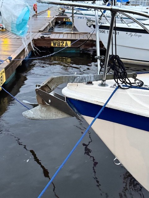

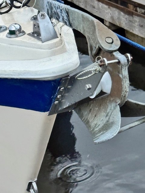

Aug 17, 2013
1,090

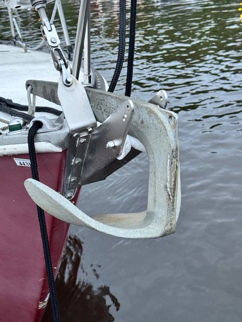

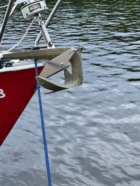

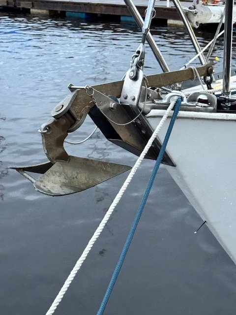

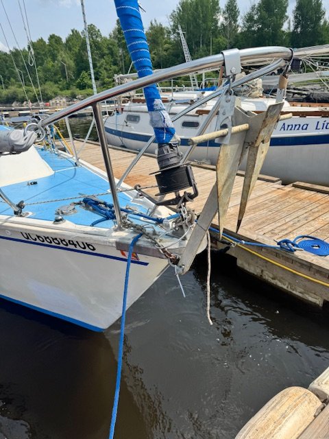

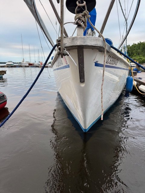

As promised, picture time
let me know what you think
I like the idea, just wondering about the overhang on my bow:banghead:

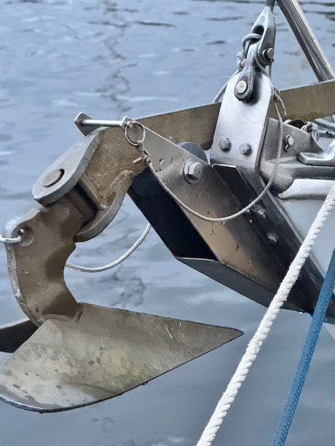

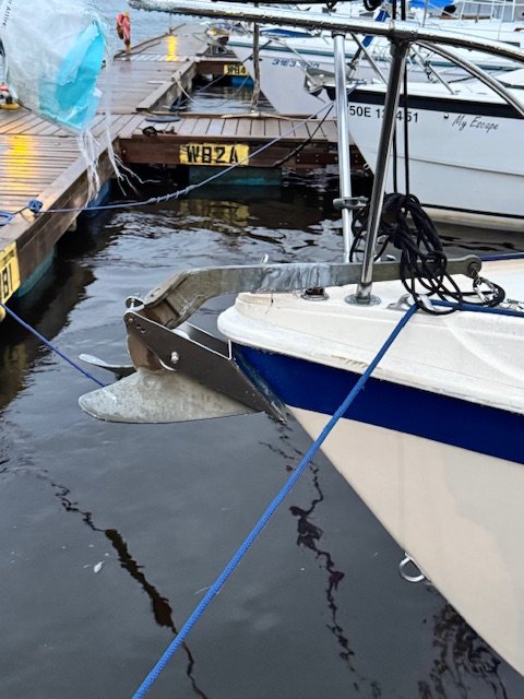

23,776
Helpful to see how the anchors hang from the bow roller when retrieved on other boats.
7. How are you planning to retrieve the anchor?
Now imagine the Danforth dangling in the air near the bow.
Where will those pointy ends be as the anchor shaft is pulled up the roller?
  • Wow
Likes: Timm R Oday25
