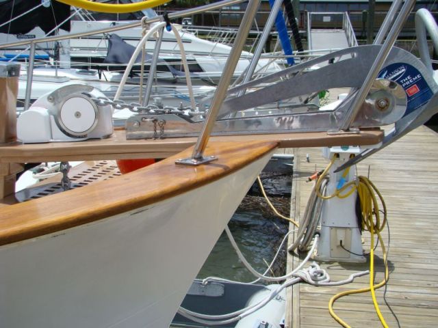

IMHO, you'd be better off with this roller: LINK
I have it on my boat and it is set up slightly offset, but works quite well. Here's a photo of the setup.

BTW, the bow roller in the photo above is normally used with a Rocna 15, and would hold a Manson Supreme 35 just fine from what I've seen.

Thanks Sailingdog, if the Rocna fits it ok then the Manson should. I'll have to take some measurements when I get back to the boat. Make a foot print pattern so when I'm here at home I can better judge what Im looking at on the Computer. My Furling unit / Forstay is right at the end of the Pullpit so I have to work around that.
