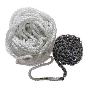

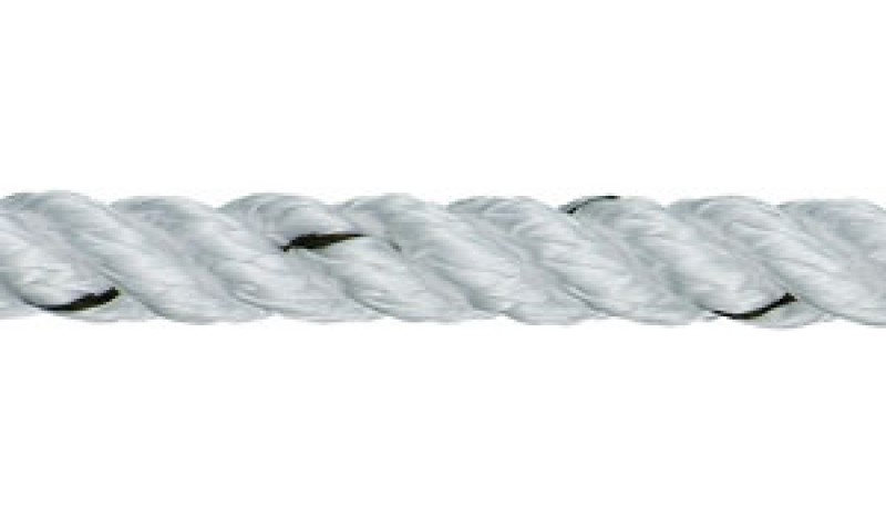

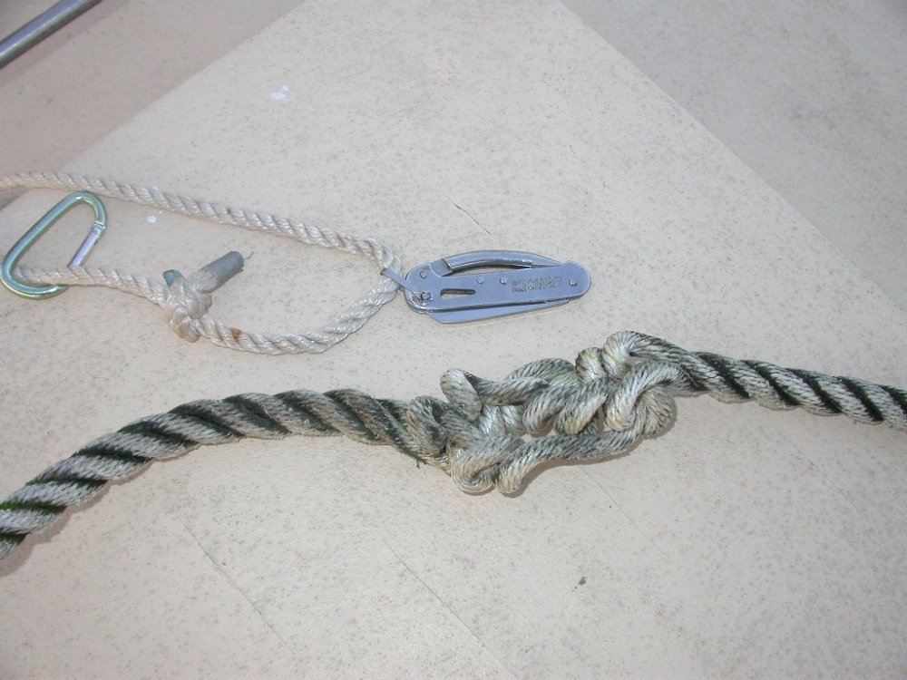

If the rode comes in around the windlass and starts down the hole into the anchor locker it should continue to fall and pile up. What stops this from happening is twist in the line. Some line twists (hockles) more than other.
3 strand nylon (a common line for anchor rode) can be the worse offender.
It is like the twist cord on the princess phones that were in homes before Cell phones and wireless phones took over.
8 plait rode is better. It fails less. It is more expensive. It is worth it for trouble less experiences.

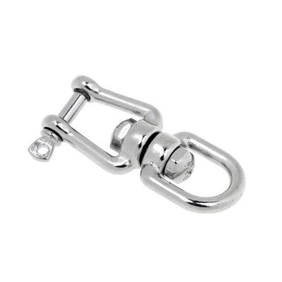

Just spit-balling, I would guess your anchor spins on the way up or on the way down. Is your anchor bent?
An answer might be to add a swivel shackle between rope and chain and/or chain and anchor.

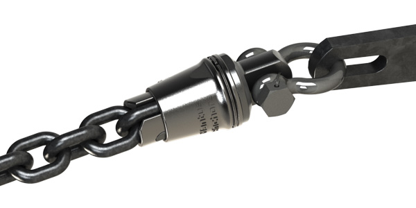

I've always tried to stay with the 3-strand anchor line because of it's favorable elastic characteristics. I have generally had good luck getting it to fall as it needs to. If the line is too stiff, I sometimes soak it overnight in a 50/50 mix of water and fabric softener. If the distance from the gypsy to the hawse pipe is too long, I sometimes make an extender for the hawse pipe out of PVC. If the line does not fit the gypsy correctly, I either get a line that does fit or I get a different gypsy. If the line is coming up twisted, I add a swivel. Some combination of those things usually produces a good result.
As for anchor swivels, I generally attach a few links of chain to the anchor, then attach the swivel then attach the rest of the chain. I have seen enough failures from side loading a swivel for one lifetime. The picture that Leslie Troyer just posted is the first swivel I have seen that might make me rethink that practice. That Mantus swivel is a new design that I was previously unaware of. I like it. If the quality is on par with the other things that Mantus makes, that swivel may become my new standard.
Oct 19, 2017
7,976
Generally, frowned upon (to use swivel in the ground tackle) - it (usually) reduces the safe working load of the rode.
I would think that would only be true if a swivel was used that was weaker than the shackle it replaced. Leslie's swivel looks both strong and streamline. You get to choose the functional load requirements when you purchase one. Having twisted anchor rode also introduced a weakness by putting an angle of rotation on the force for the pull of the anchor when set. There is that kinking issue that weakens too.

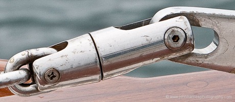

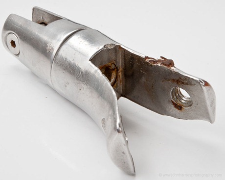

In general, ground tackle is a pretty hotly debated topic among sailors, with many people having strong opinions that don't always agree. Choice of anchor is something that few seem able to agree upon. On some web forums, the debates over them gets pretty heated. I guess that I should not be surprised to encounter opinions on swivels that contradict mine as well. The cordial nature of that discussion here is a welcomed change from other forums.
To date, most of the people I have met that don't like swivels, were people who were not aware of how to use them correctly or were on boats with anchors that got pulled up by hand. If your reasons for not liking them are something other than this, please help me to understand the shortcomings that I am unaware of.
Around here swivels are pretty popular on bigger boats. I have also seen them on the pulpit of a brand new multi-million dollar yacht at the factory. Most every mooring I see around here has at least one swivel.
There are many different swivels out there. The cheap ones are certainly to be frowned upon, but the better quality ones have a pretty good track record when properly installed & occasionally inspected for degradation. Most of the failures that I have seen have either been from improper use or corrosion after long term use. Both of these issues are avoidable. Below is an example of improper installation & the resulting failure from a side load during a tide change. This failure could have been avoided with the addition of a few links of chain between the swivel & the anchor.
