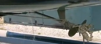

I couldn't find any reference in the video either as to where the water was coming in. If you look at the last part of the video after the boat is hauled, it looks like there is lot of water coming out from just ahead of the shaft strut, possibly around where the shaft enters the hull. I agree about the pump - looks like the cheapo hand pump that W.M. sells. I use one to dry out my bilge but would never count on it to pump 3-5 gals a minute in an emergency.

If you look at the closeup shot of the prop you can see where the leak is from and why it was caused.
Here's my theory...
The rode wrapped around the prop has it's tension pulling FORWARD and DOWN since the other end of the rode seems to be securely attached on the bow. The force pulling down and forward pulled the prop shaft down in the shaft log and cracked or holed the hull where it enters.

The engine going forward when it cinched in the line, pulled the shaft and strut and broke the hull where the strut mounts to the hull. He's lucky it didn't tear the strut completely out. Without some real quick damage control that would have sunk her good.

I'm sure the Prop stopping wasn't very gradual , Line was being wound up with a slight slowing then when it got to the end and became taught....That sudden stop caused the crack / brake .

A friend of mine, prior to becoming "very experienced", had a dock line coiled on the after deck go over the side and into the prop. It wrapped around the shaft in a neat spiral and the leverage of it filling up the space between the prop and strut created enough force to break the adapter plate that mounted the transmission to the flywheel housing and pull the transmission right off the engine.
From the video, I would guess that the engine was on flexible mounts and pulled back far enough that the coupling pressed on the flexible stuffing box or shaft seal and split the hose or bellows. Might have broken his engine mounts as well.
