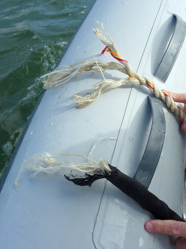

You need to use the right double braid for the job. Perhaps the best and strongest mooring pendants made today are a double braid made by Yale Cordage and called Yale Polydyne Pendants.. Failures of Yale pendants in storms here in Falmouth, ME, with over 1100 moored vessels, has been next to nil yet three strand, lots of failures. Like the one below on my neighbors boat. In ten years monitoring Falmouth storms I have yet to see a Yale Polydyne pendant failure and they've bee put through the ringer..

This is what only 40 knots does to our mooring field.. Three strand, no way, not for our boat....

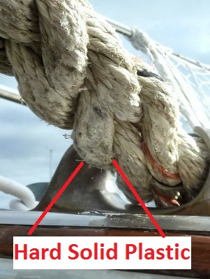

The biggest problem with pendants is heat. Nylon begins to lose considerable strength above about 300F. For this reason chafe gear that breathes and is NOT water proof is better suited than leather, fire hose or rubber tubing. I have seen a number of solid hard spots in nylon pendants after storms. These hard spots are brittle and lead to failure far faster. With a three strand line this is harder to detect as the entire line is rather hard and stiff after use or after a storm. A good double braid can be kneaded between your fingers along it's length, especially where it went over the chocks, and inspected for hard lumps or hard spots and retired if necessary. Because of the nature of the braid inside a double braided line identifying hard spots is much easier. I do this after every storm and it takes about 5 minutes.
This was a hard spot I detected after a Nor' Easter her in Falmouth, ME.
I needed to really poke at it to tell as it is very tough to see visually. That entire lay is toast yet I can almost guarantee the owner would have never identified it so I left a note and marked it with a Sharpie marker...
When these lumps occur in the middle of the line it is all but impossible to tell.
