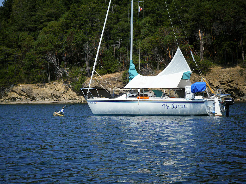

After one of those frantic "at dusk" (boat rode all day without incident) #@$% the ^%$# anchor broke loose in a 35 knot blow, I knew it was time to look at the anchor riding sail concept. My boat "jack-knifed" on the anchor that night due the high bow free board which put me broadside to the wind. It has a tendency to swing about 120 deg. total in a good breeze anyway, but once the bow got "hooked" by the wind it just would not come back into the wind, the force heeled me about 8 deg. before she broke loose.
So this year I bought the ARS from Sailrite and am amazed at the difference, boat only swings about 50 deg. total in a heavy wind and about 30 deg. in a light breeze. Will never anchor without one again, much more comfortable ride and I sleep a lot better.
I experimented a little because they suggest it be secured off to one side, I found it to be much more effective for me to have it on the centerline.
Thought you ought to know.

We use one....
...most nights with the MacGregor and it does help a lot. More on it here....
http://purplesagetradingpost.com/sumner/macgregor-canvas/canvas-5.html
The Endeavour so far doesn't seem to sail around on anchor very much at all, so we probably won't sew one up for her.
We mounted ours off center as per Sailrite's instructions and it seems to work well like that. At first we had it higher on the backstay and then moved it as low as the solar panels would allow and that also helped.
I have two youtube videos with the sail up....
Aft Video: http://www.youtube.com/watch?v=vkLbyBld1lY
Bow Video: http://www.youtube.com/watch?v=MKjU842c9Zo
...but none not using it. The boat does sail around much more without it though,

Have been using mine for many years and love it. I fly mine on center.... run up back stay then bring line forward and anchor to bottom of mast. I pull my boom over to opposite side as not to chaffe.

We bought the smaller one for the Mac and it is for boats up to 35 feet. We bought the kit...
....and Ruth sewed it up.
You can also buy them finished for not to much more...
http://search.sailrite.com/?freeText=anchor sail
Here you can click on the video showing them in use or how to sew them up....
http://www.sailrite.com/Anchor-Riding-Sail-Kit-12-5-Sq-Feet
It .....
...hanks-on to the backstay and ties off to the side if you do it like they suggest. I use an uphaul to take it up the backstay. I have another line at the bottom that clips on the boat to keep if from riding up the backstay. I can have it up in just a minute or so. Not sure what someone does that has split backstay, but that might be covered in the video above,

The wife made ours from a Sailrite kit. It worked wonders. Ours hooks on the back of the boom at the topping lift and we use the main halyard to raise it. I swing the boom to one side and tie it off. Also if anchored in one of the rivers around here with a current you can play with the rudder to help keep it swung to one side.

Being a cheap bastard I made one out of a corner of an old pentex genoa. The boom tent is a $10 painter's tarp cut down to size.
The only problem we had was when the wind and current were opposing. That put us at 90 degrees to the waves at about 1AM. Second night it happened around 2AM and I figured out what was happening. The next morning we moved to a different mooring out of the current. :)
