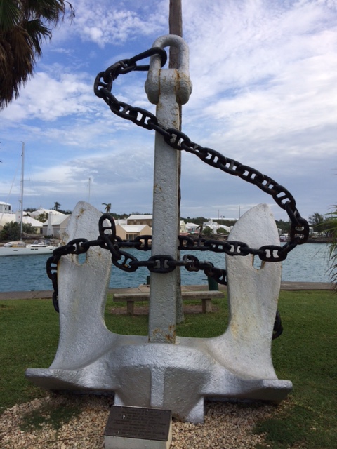

Try this
Oh boy, let the religious wars begin...
7,762
This is going to be worse than the Sunnis vs. the Shiites. Or is that going to buy me an NSA visit? Only kidding guys!
