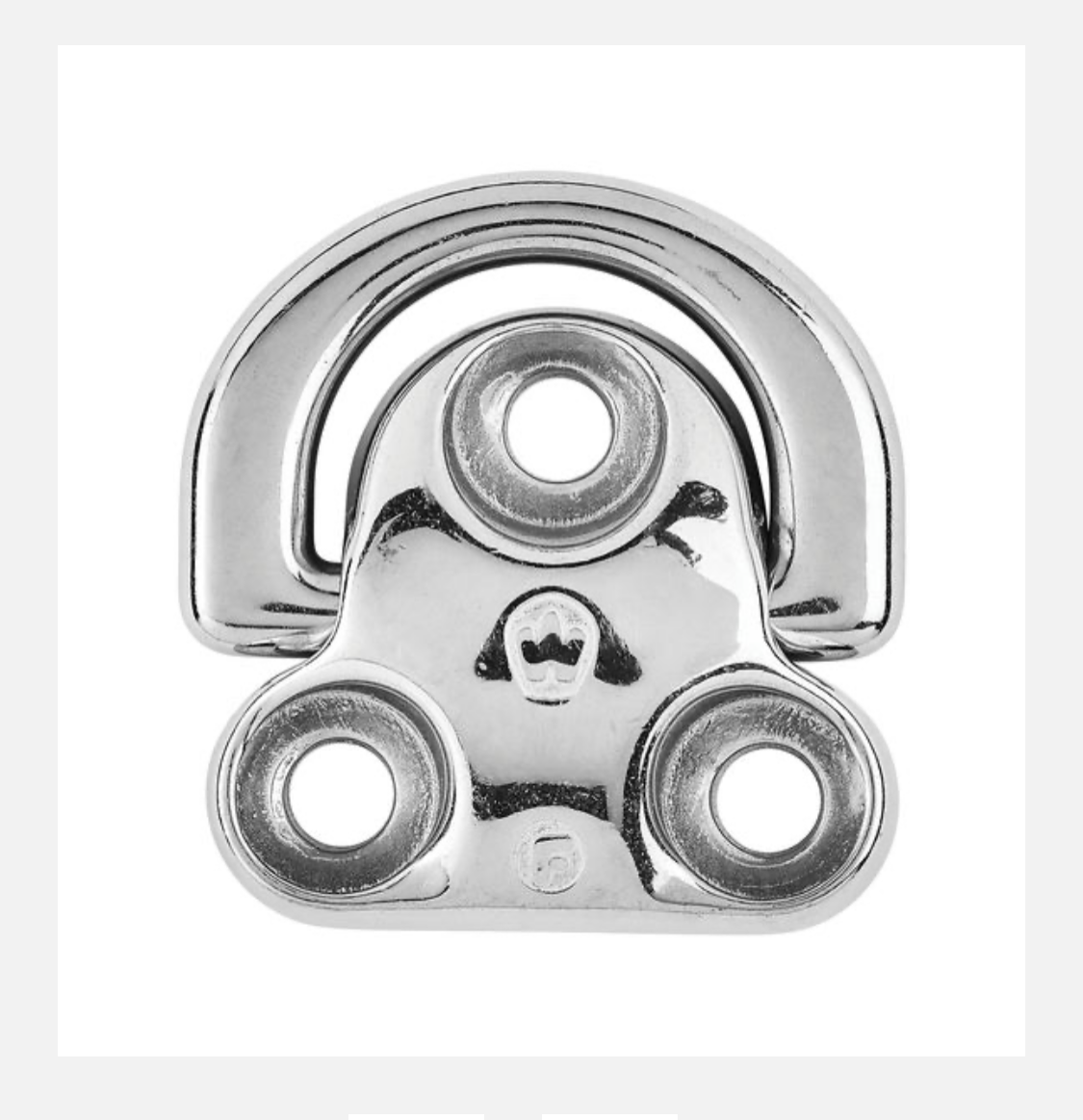

Assuming solo sailing, you will need the tether to reach all of the points on the boat needed to control the boat. This would require moving from the helm to the companion way. Assuming a 6 ft tether you could run a jackline on the sole of the cockpit from just behind the helm to the companion way. Attach two folding pad-eyes to the sole as strong points on either the port or starboard side of the helm. Then secure tightly the jackline to the pad-eyes. I use the starboard side on my boat. My tether stays attached to the jackline. As I climb the ladder to get to the cockpit the tether is hanging there to attach to my harness. I know where I’m going and I know there will be nothing to trip my feet as the rule on the boat is “The starboard pathway and JackLines are required to be free of all obstacles so access is unrestricted!”
8 mm Wichard Marine folding padeye.
2400kg working load
5000kg breaking load
Materials 17.4 pH stainless steel
316L stainless steel grade

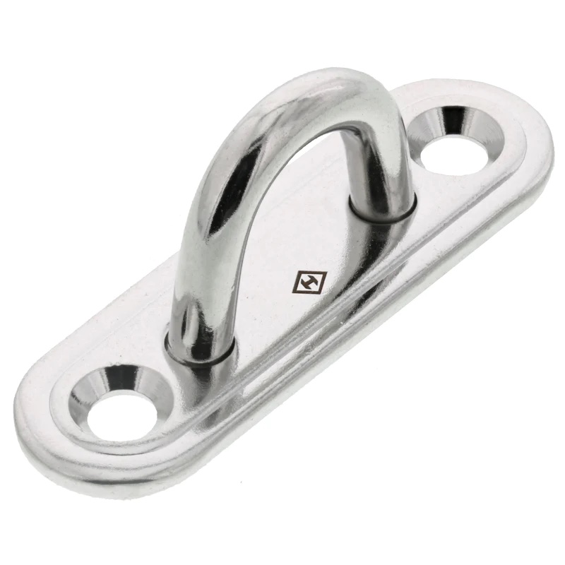

My boat has a rather substantial pad eye bolted to the cockpit sole, just behind the pedestal.
Like this:
Like this:
I have four of these type padeyes in the cockpit; two at the base of the companionway on either side through-bolted to the cockpit sole. The other two are on either side of the helm seat near the cockpit sole, but through-bolted just above the scuppers. I have two short (length of cockpit) jacklines that run fore-aft between each pair of padeyes. If I'm sitting at the helm tethered to one or the other of the two jacklines I can move forward to the campanionway on either the starboard or port side of the cockpit. Thus, I can reach all four of the sheet winches and the two cabin-top winches while tethered. And can even descend through the companionway a short way w/o unhooking.
If I wish to leave the cockpit I have starboard and port jacklines that run the most of the length of the deck, so I can hook into either of them to go forward. The attachment points for the those long jacklines are padeyes through-bolted to the deck. The Bavaria 38E was already rigged this way when I bought it in 2004, but I've since replaced the jacklines.
