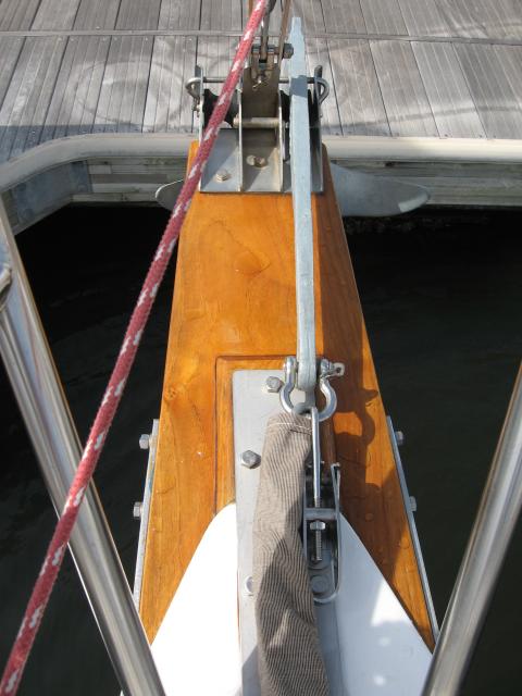

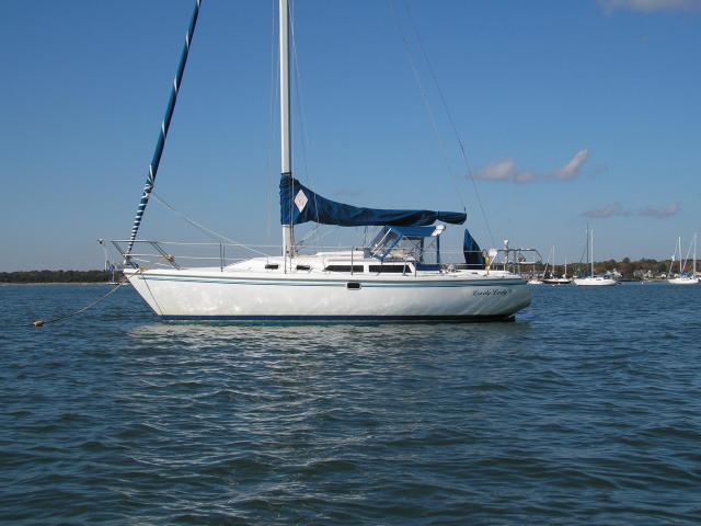

Bill,
Not sure what style anchor you have. I use a Mason Supreme which is easily tied to the bow rail. Not sure if you can see it from this. The problem for me is I'm on a mooring. After seeing a post by MainSail about the dangers anchors pose on a mooring I now remove it and stow it when I leave the boat. It is a pita.

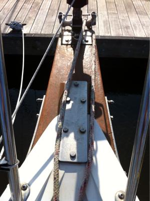

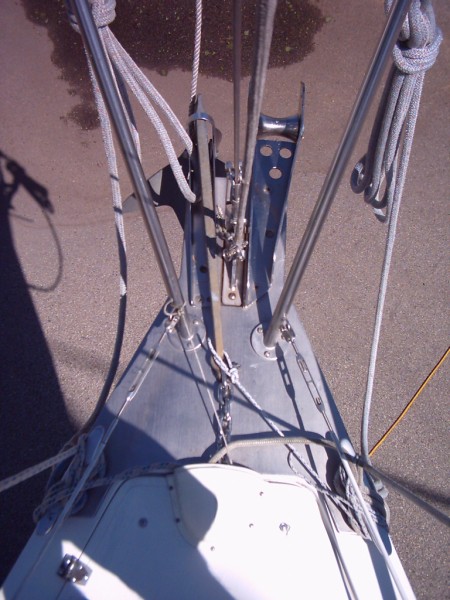

It is hard to see in this picture but if you look hard enough there is a little metal part that you see on the bow sprit. That is where the chain stop is.

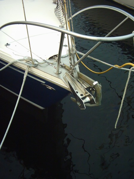

I mounted one of these tensioning devices and it's worked out pretty well on my 22lb claw type anchor.

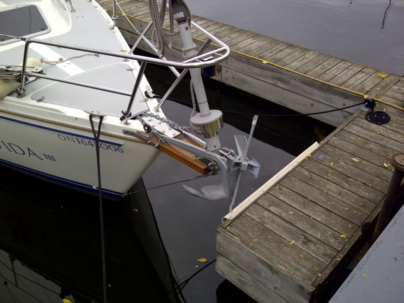

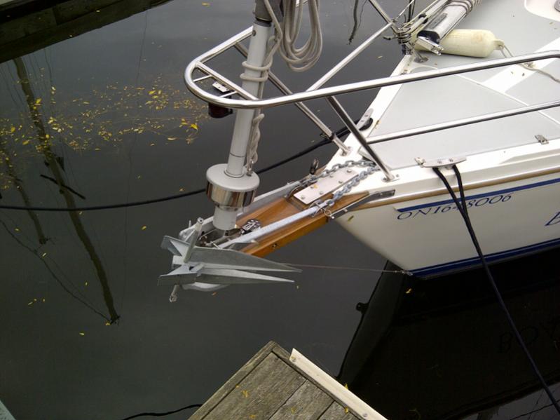

Here is how I have my 1991 tall rig set up. With the danforth on its side locked in place I'm able to keep both the bruce and danforth in place on the bow sprit.

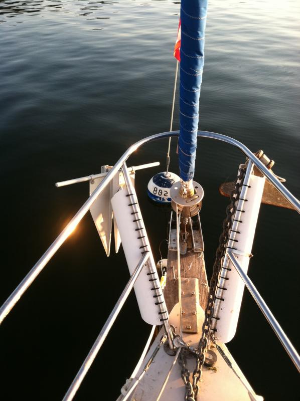

I keep my Catalina 30 TR on a mooring and rarely use a slip while cruising. I have cable tied a length of 4" PVC pipe to each of the two most forward leaning members of the bow rail. My 22lb CQR with swivel and chain goes into the starboard pipe. My Fortress 16 with swivel and chain goes into the port pipe. The rest of the chain and rodes go easily into the anchor locker. This configuration keeps the anchors off the rollers and out of the way of anchor rodes, bridles, mooring pendants and such even in punchy seas. Either is also immediately deployable by lifting the anchor locker lid to access the extra rode and chain. It takes a bit of finess cutting of PVC and angling of the anchors to make it nice, but once done, it is quite convenient.
Good luck with however you work it out.

FOB,
Thanks for the photos, it is now clear to me and thanks to BillyK for asking the question. Can either of you explain to me the differences btwn the Catalina 30 models? For example, I have an '87 30 MKII tall rig. I understand the MKII is an upgraded boat but what makes it different from a standard 30? Is there a difference. I'm in a small marina with the only Catalina and have no other Catalina 30's to compare to. Curious. Thanks for your time. Derek
