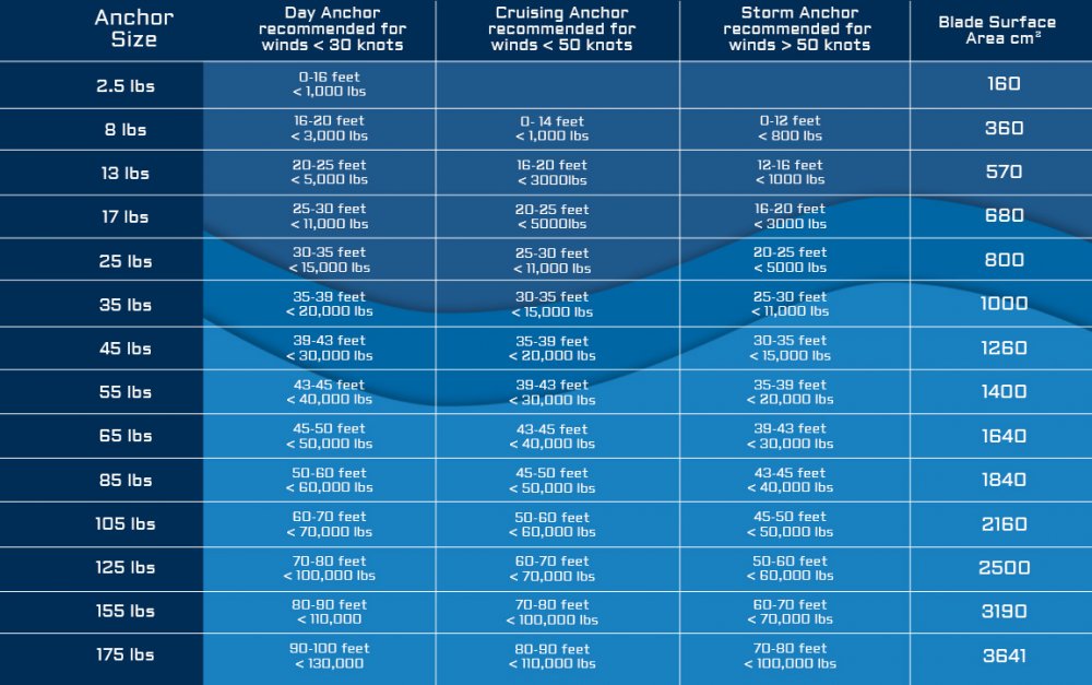

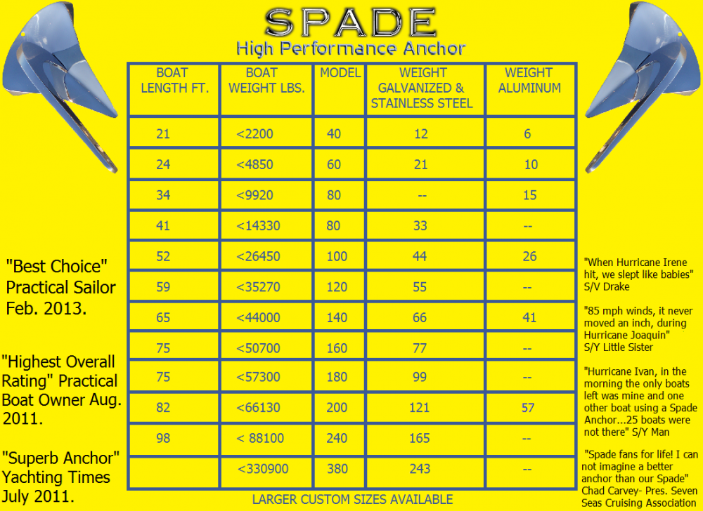

As the selection of an anchor is the Captains choice it is not a question that can be answered as asked.
I look at the boat length, displacement, anticipate weather for the area I’m sailing, types of bottom for the anchorages, then make a selection that accommodates best the various factors leaning to a size bigger than the minimum and extra rode to deal with the worst expected conditions.
My boat is 35 feet and 16000 lbs displacement. Chain is 105 ft (33 meters). And rode is 250 ft (77 meters). Primary anchor is Mantus 45 lb , secondary is a 30 lb danforth with 80 feet of chain and 150 ft of rode.
You boat is 36 ft long 13228 lbs./ 6000 kgs.
The spade or Mantus are both great setting and holding anchors. They have the following charts to help with your decision.
https://www.mantusmarine.com/mantus-anchor-knowledgebase/anchor-sizing/
