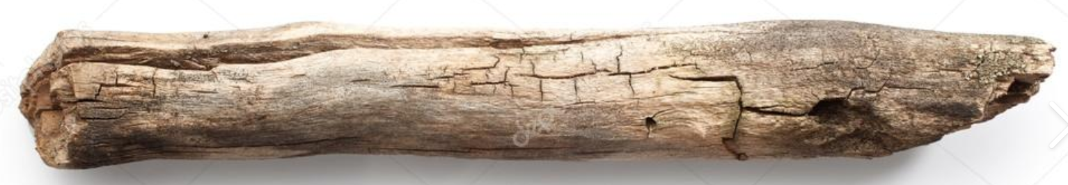

I recently purchased a 2002 Hunter 326and found a loose piece of wood in the anchor locker and discarded it. When first using the electric winch to raise the anchor chain, the chain piled up in a zigzag fashion against the rear wall of the locker and jammed the winch, instead of piling into the middle. I thought it must be the boat sloping backwards when I was in the boatyard, but had same problem on the water even with the bow dipping slightly. I surmised the piece of wood was probably wedged across, to guide the falling chain towards the middle. What baffles me is the winch fits the molding and can't see any deviation from the original build. Surely the single previous owner from the outset didn't accept a faulty new build and patch the issue with a lump of wood! Is there anybody out there who has had the same issue?

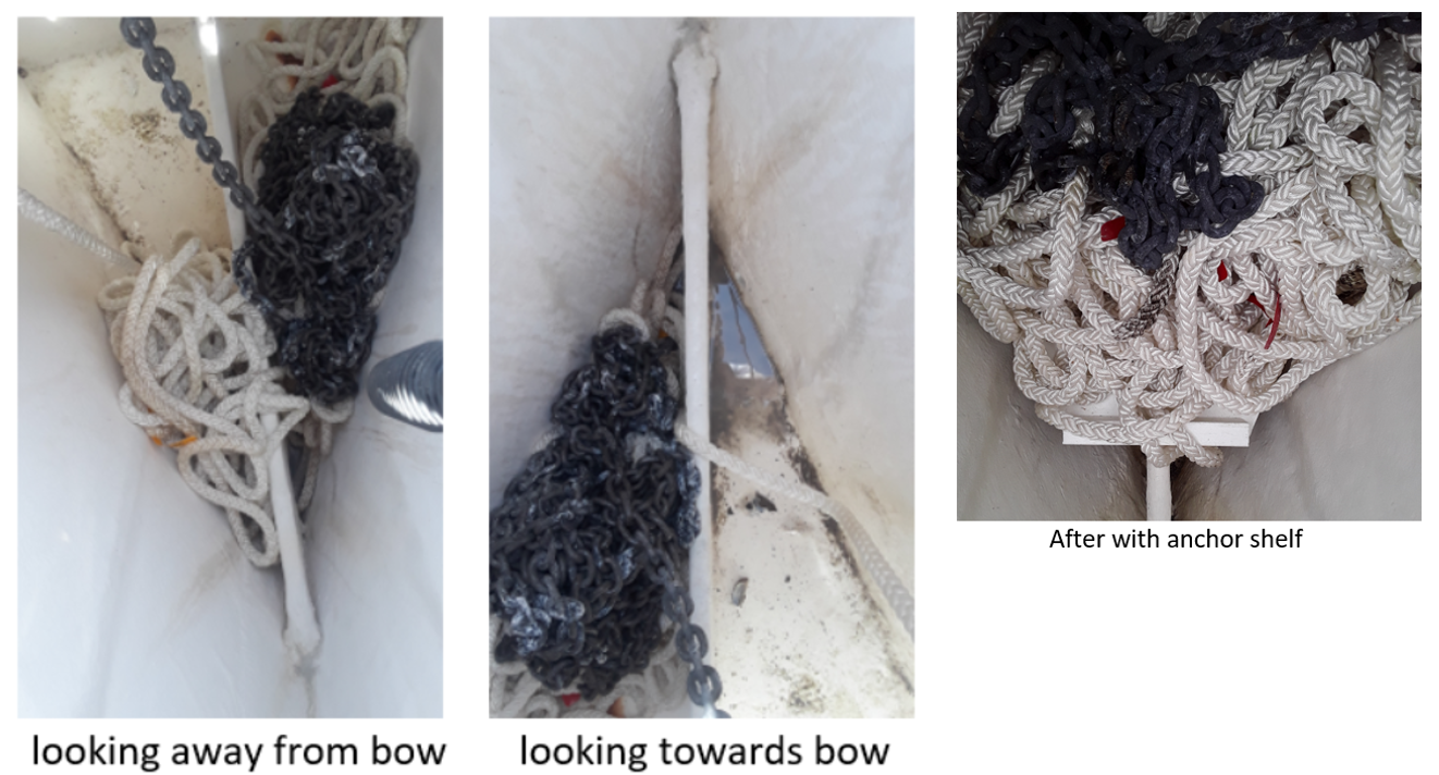

Same issue on my Hunter 46 so I fabricated a platform out of 1/2 inch thick fiberboard with legs screwed into the underside. This mitigated bunching up the anchor chain and warp on one side of the anchor locker and kept it above the drain hole so they would dry out as discussed in this thread

The photos below is my anchor locker before shelf (left and middle) and after shelf built (right). Before the rode was all bunched up and after is is neatly flaked on the shelf and has stayed that way even after sailing in heavy winds and waves.
