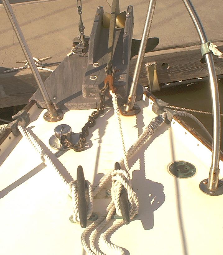

Yes a cleat to tie off for sure and would be so easy in case of problem and needing
to let out that anchor and tie it off when done,something easy in case of a emergency.

I use a snap link on a line tied to the pull-pit. Just link through a link of chain so the line is tight.

If you are using all chain, you need to install a proper chain stop on deck. You will also need a properly installed cleat on the foredeck to tie your snub line to.
When the anchor is on the roller, the chain stop will hold it in place. Many rollers have holes where a rod will go through the ears of the roller and through the anchor.

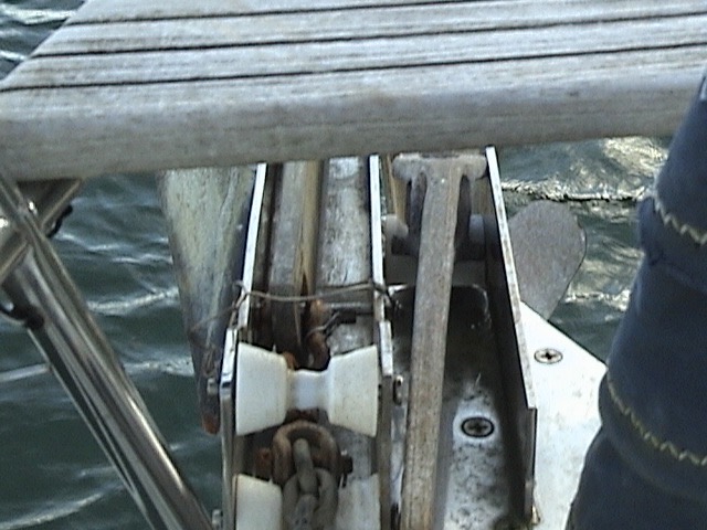

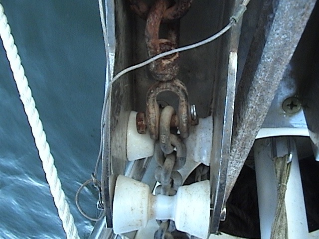

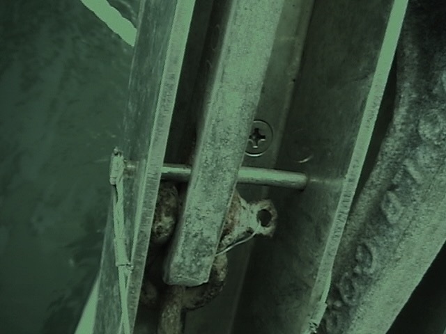

Our Danforth has a slot on the end of the shaft where the chain shackle connects. When we took possession in 2002 the PO used a bungee to secure the anchor to the roller. I wanted something more permanent so I drilled a quarter inch hole through the sides of the roller in line with this shaft slot. I made a SS pin from a long bolt, cut the threads off, then drilled a hole on the end to accept the SS locking cotter pin that I fabricated from a heavy SS wire ring. A SS cable lanyard is used to secure the cotter pin to the roller.
In all the years since, anchoring hundreds of times in all kinds of sea state, this has worked very well for us in these PNW waters. This device was easy to make, strong, and very secure. There have been a couple of times that I banged the anchor into a pile or some such thing, bending the pin. Easy to straighten with a hammer. A second pin with a lanyard and cotter is kept as a backup. The original still works just fine.

Here is what I did for our anchor lock. Drilled a 1/4" hole through the bow roller in line with the anchor shaft slot where the chain shackle attaches. Found a SS bolt long enough to extend through the bow roller with the threads cut off. Drilled a small hole through the bolt head for the lanyard and the bolt end for the cotter pin. Lanyard made from SS strand wire secured to the head with compress fitting. Ditto the cotter pin made from a SS ring.
The PO used a bungee cord to secure the anchor to the roller. Wanted something more secure, simple, strong, low cost and reliable. Made this in 2002, anchoring hundreds of times and in all kinds of sea states. Works well for our needs.
