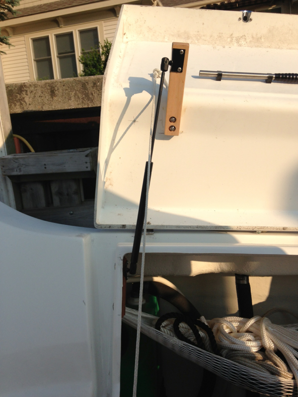

My 323 has a lazarette seat hatch that would have made a good guillotine. I installed a gas strut, and kept the original stopper line in place to prevent over travel. The single strut has made it much safer, and has worked for the last five years. Because the strut will eventually wear out, I am going to replace it as a precautionary measure this year. I am considering the addition of a second strut simply for better balance.
23,167
Doug, that looks like a super arrangement. Can you get a stronger strut? Or would that not make any difference in your setup?

Stu,
The struts are available in a multitude of stroke lengths, and differing weight capacities. Since I sail in fresh water, I used automotive struts at less cost than stainless steel.
