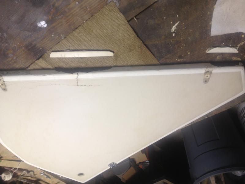

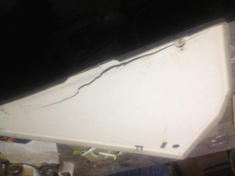

I have an O'Day 34 with a cracked anchor locker hatch. The boat yard said they could make it almost like new again for $1600 or epoxy it back together for $350. Any suggestions as to how the repair should be made and does anyone know where I might find a new or used hatch cover?

Shocking prices either way. Why don't you post up a picture of it. Also, are you willing to do any repair yourself?

Yes. I could do a fiberglass repair. The hatch cover has a core which is broken. I'm not too concerned about the cosmetics and I know that the crack would still show even if I repair it from the underside. Should I try to epoxy glue the crack and reinforce it with fiberglass on the underside? If so, how many layers would be necessary to give it enough strength to stand on it?

Experience? I don't think so. Take a picture and I can suggest a method of repair. Take photos of the top and bottom please.

It's never easy. I hadn't realized that the hatch cover is curved so unless I use a very thin plywood that I can bend and find large enough clamps to clamp the middle, that method won't work. Also, the main part of the hatch has a core but is tapered to the outside edges and that's where the main crack is. If I put a backup board across the entire hatch, it wouldn't close. If I cut it down to where the taper starts, it won't cover the weak points and the crack. The boat yard suggests I just poor in as much structural epoxy as I can and clamp it back together.
