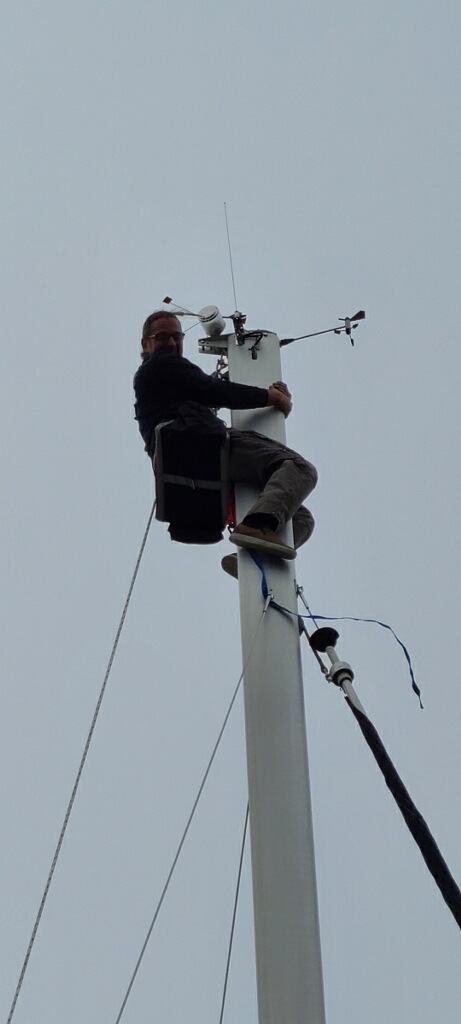

Here is a picture of me and my anchor light. I cannot find a replacement for this thing? Any thoughts? I am having a hard time even getting the housing off as you can see. Any advice on how to replace bulb or housing? Where to find? Or do I need to upgrade the whole thing?

Not a clue.
However, you can see a weakness of many bosun's chair systems. You can't get above the masthead. With a Mastmate (and many other systems) you can get rib-high or so, which makes the work much easier.
You can also see my weird looking early-LED anchor light. Not easy to open and nothing you can service away from the workbench anyway. I ended up replacing it a few years later with a Tecniq M10. Much smaller and lighter. The older LED light was such a cool hand-crafted piece
I replaced my entire assembly, but I also took the mast down and worked from the ground. I had to make a special adaptor to mount the new light, machine new mounting holes in the mast head, fit the adaptor, mount the light on the adaptor. I don't think I could have done that with the mast up. Or at least it would have been so much more difficult that dropping the mast was a no-brainer...
dj
I had to make an adapter (the new light was too short to see over the wind vane). Had to tap new holes. Mast up, no problem, but it did take two trips, about 15 minutes apart. The addapter was a length of PVC pipe the same diameter as the light. Perfect fit.
It would have taken longer just to get a price on dropping the mast....
a. Comfortable harness with extra padding.
b. High position.
c. Organize you tools in an electrician's ladder bag.
d. Many, many years experience climbing and working at height.
No bumble fingers, don't drop anything.

I had to make an adapter (the new light was too short to see over the wind vane). Had to tap new holes. Mast up, no problem, but it did take two trips, about 15 minutes apart. The adapter was a length of PVC pipe the same diameter as the light. Perfect fit.
b. High position.
Nice summary of how to work at the top of the mast. Keeping the mast up or having to take it down does depend upon just how much work, and the extent of the work you need to do there. There is a lot of work that can be done with the mast up - perhaps more than one may think, especially when hanging up there. :waycool: The high tension electric line workers are amazing what they can do hanging from the treetops, so to speak... LOL
