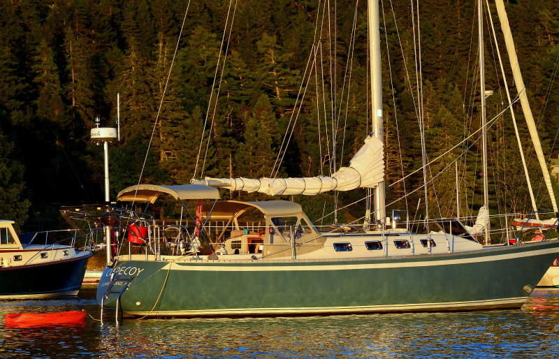

I have an anchor light mounted to my radar pole on the stern. I have at least 358 degrees, or more, of visibility with it as I have circled in my dinghy at night and can hardly find a break in the light. Not only that it lights up my bimini and boat around it so it can be seen very well as you get within 1/8 of a mile. I still keep one at the mast head too but rarely use it as I feel much safer with the radar pole anchor light.
